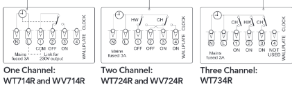

Wiser and a lot more use a universal mounting plate.
Some makes only use one and two channel, and same plate also used for programmers and thermostats, and the opentherm is a add on module 1730725712902.png which comes with the wiser anyway. The hub 1730725841759.png can connect to TRV's, wall/free-standing thermostats or both, it relays information to the boiler, from the TRV or thermostat.

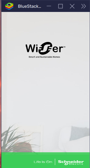

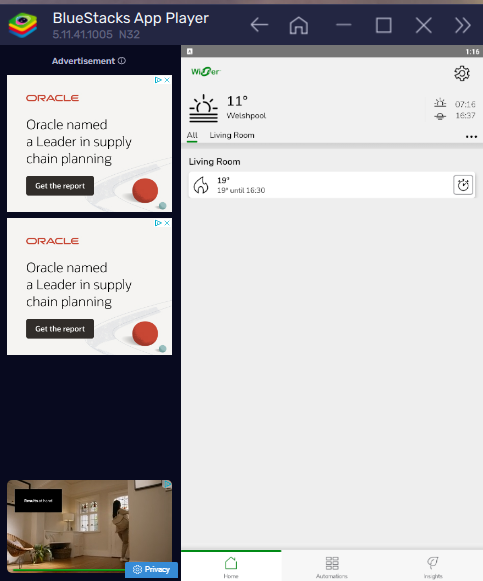

Bluestacks 5 is designed to run phone and tablet stuff from a PC, I get this far 1730726129816.png then it fails, well until today, ran it again to get the screen shots and 1730726270297.png it has actually worked. 1730726404770.png it has never worked before, so yes can set temperature from the PC.
My Nest Gen 3 was on paper the best option, but in real life a bit of a failure. But still have it so I can use boiler for domestic hot water (DHW) when required. The Wiser would not work my DHW, due to my running a C Plan. Hive has a software work around. And Nest has volt free contacts and you can wire out of the com terminal, but since you it seems are not using C Plan you can forget about that.
Wiser and Hive single channel can run volt free, two and three channel have to be low voltage, in the UK that means 230 volt, USA for some reason known only to them, do not use the international standards organisation definition of low voltage, we call 12 and 24 volt extra low voltage, they don't it seems, so if you read USA stuff, you must be aware, of their odd English, boot is a trunk etc.
