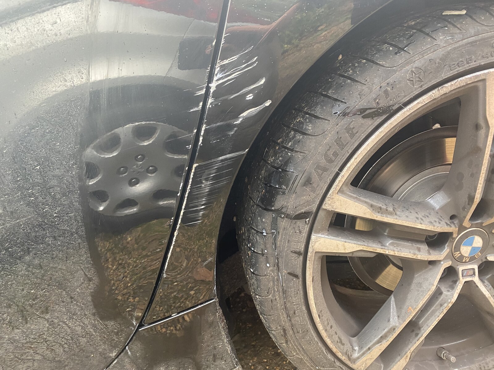

Hi all. See attached pic, the weather got the best of me and I had to rush inside. I think it needs another attempt :notworthy:

Yeah, definitely worth another go. Keep working the area until you have got a sweat on that means you don't feel the cold! It is hard work by hand as you are doing the work of a machine polisher.
That being said, looking at your last photo, it doesn't look too hopeful you are going to get it to a stage where you don't notice it so much. If that does end up being your summation, I would look for a good local Smart repair type of guy who would be mobile and come to you and do it on your driveway.

Thank you, I did message a smart guy who said he's unable to do it as it is on the metal bodywork...
If you can feel it with your fingernail it needs painting.
Even filling the scratches with colour matched paint stick, leaving it a week and then polishing it out will look a lot better.
Evening everyone, I have decided to let BMW repair the damage. After negotiating I managed to bring them down from £1,000 to £500 not bad thinking local bodyshop repairers wanted more or less the same price. Obviously it’s a big hit and something I could have completely avoided but lesson learnt I suppose :sneaky:
