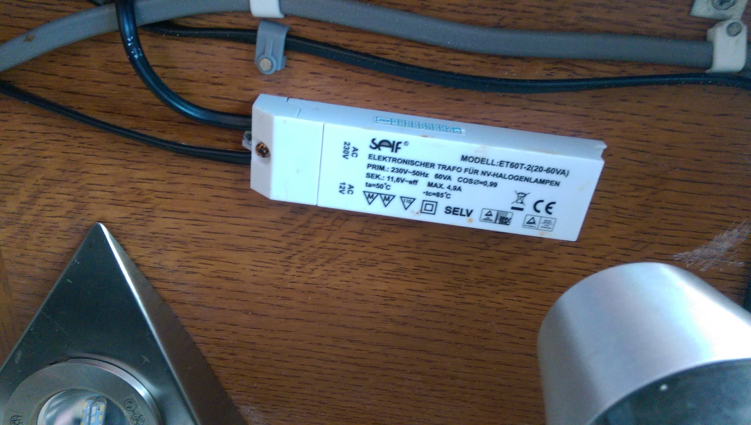

Hello all,
already have led G4 lamps in holders, fed by these transformers.
Would like to swap out the individual lamp holders, and replace them with led striplights.
To minimise faffing, would just like to disconnect the current holders, and wire led striplights to the current transformers.
Given the attached, can this be done?
If so, any links to suitable kit and lights i'd appreciate.
TIA
Very unlikely to be compatible, buy matching power supplies to go with the new LED strip. The ones you have currently are high frequency AC power supplies, LED strip almost always requires a fixed (usually 12V) DC supply.
