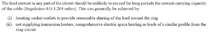

As you say, although it is unconventional and probably fairly undesirable, there is not an explicit regulation against it. There is, however, a recommendation ('guidance') in Appendix 15 of BS7671 that immersions should not be supplied by ring final circuits. That seems pretty sensible, since an immersion is one of the very few domestic loads likely to draw 3kW for appreciable periods of time ...
Also, even with washing machines and tumble dryers, the plugs have been reported to sometimes overheat, and they generally represent less of a continuous load than does an immersion.
