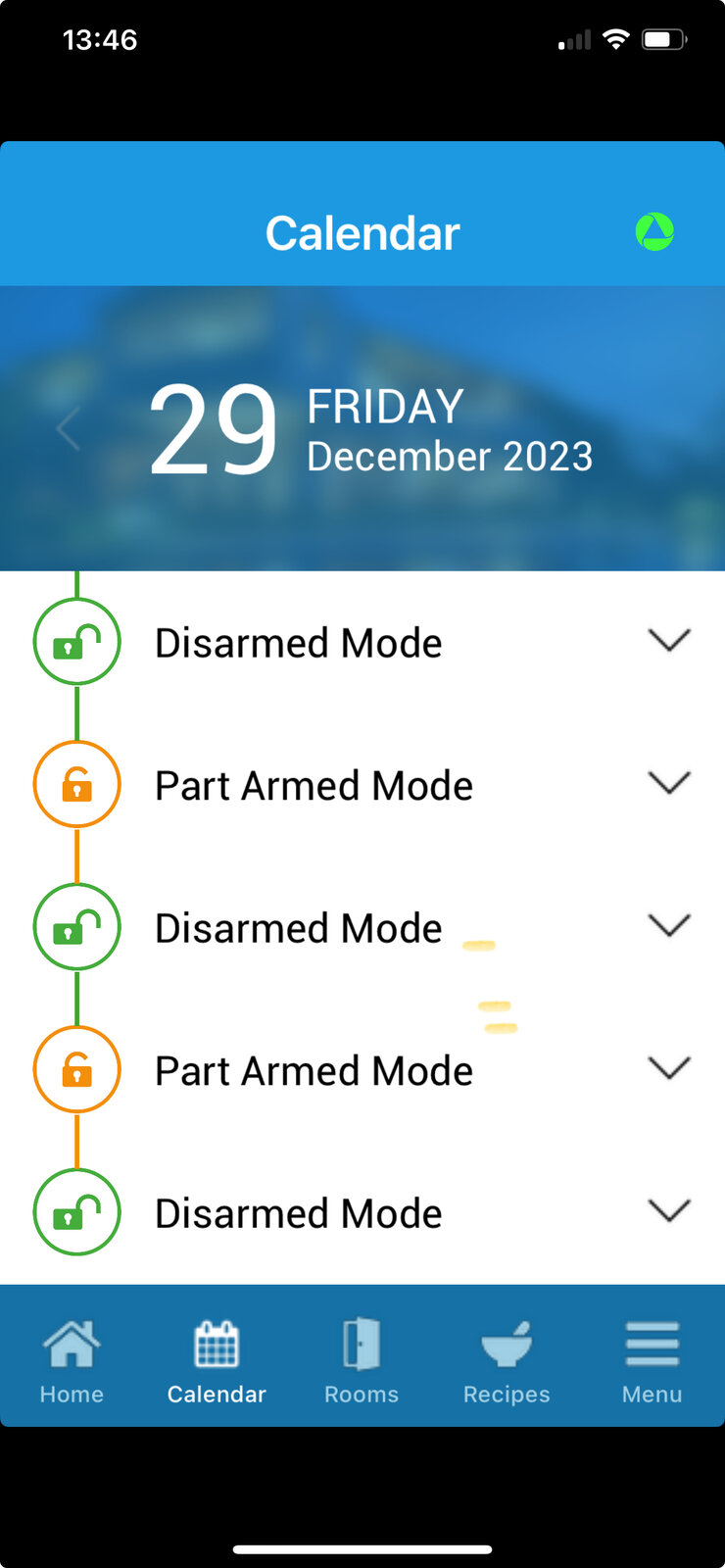

Unfortunately, changing to E/E made no difference; the app didn't report exit arm but did report the entry disarm.
Is it possible to do the panel changes sparkymarka suggested but in wintex, if not can anyone provide key panel strokes?
I'll live with it if not, its only a mid-holiday tinker that's been on my mind - not the end of the world.

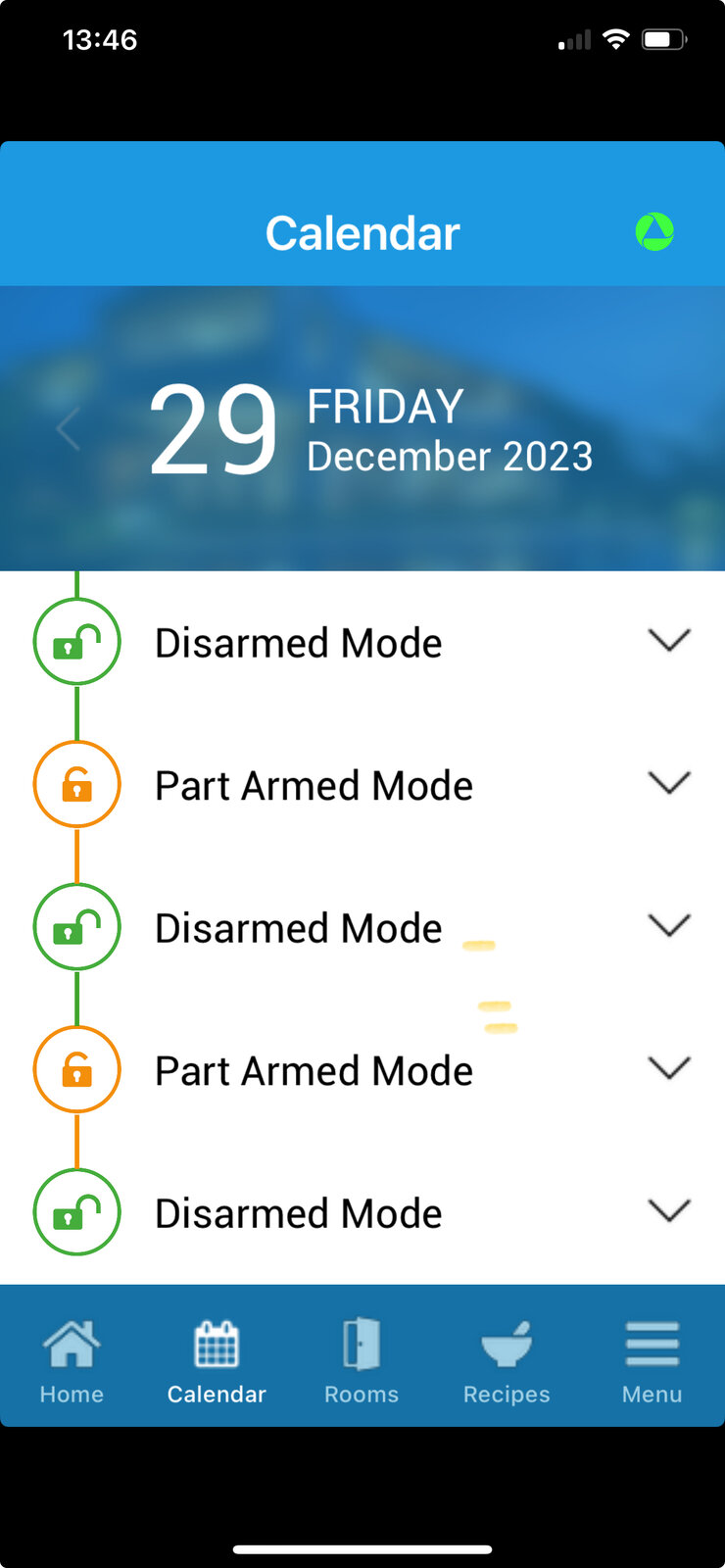

That sorted it, many thanks. It reported it on the app when set from both RKP and from App which is certainly a first. Strange however that after a couple of minutes the arms disappear from the calendar and it only shows disarms. I guess that can only be texecom goings on in the background of the app. See the times of screen shots.
I think we’ve got this as far it it will go many thanks for your help
Hmm that’s interesting.
Looking at a few systems and the details are showing correctly.
What would ask Texecom for comment.
I can see on some of the systems in my care show arming and disarming in the calendar.
These panels are on version 4 smart com and versions 5 .x and 6.x and none have anything that’s chargeable in terms of texecom cloud
