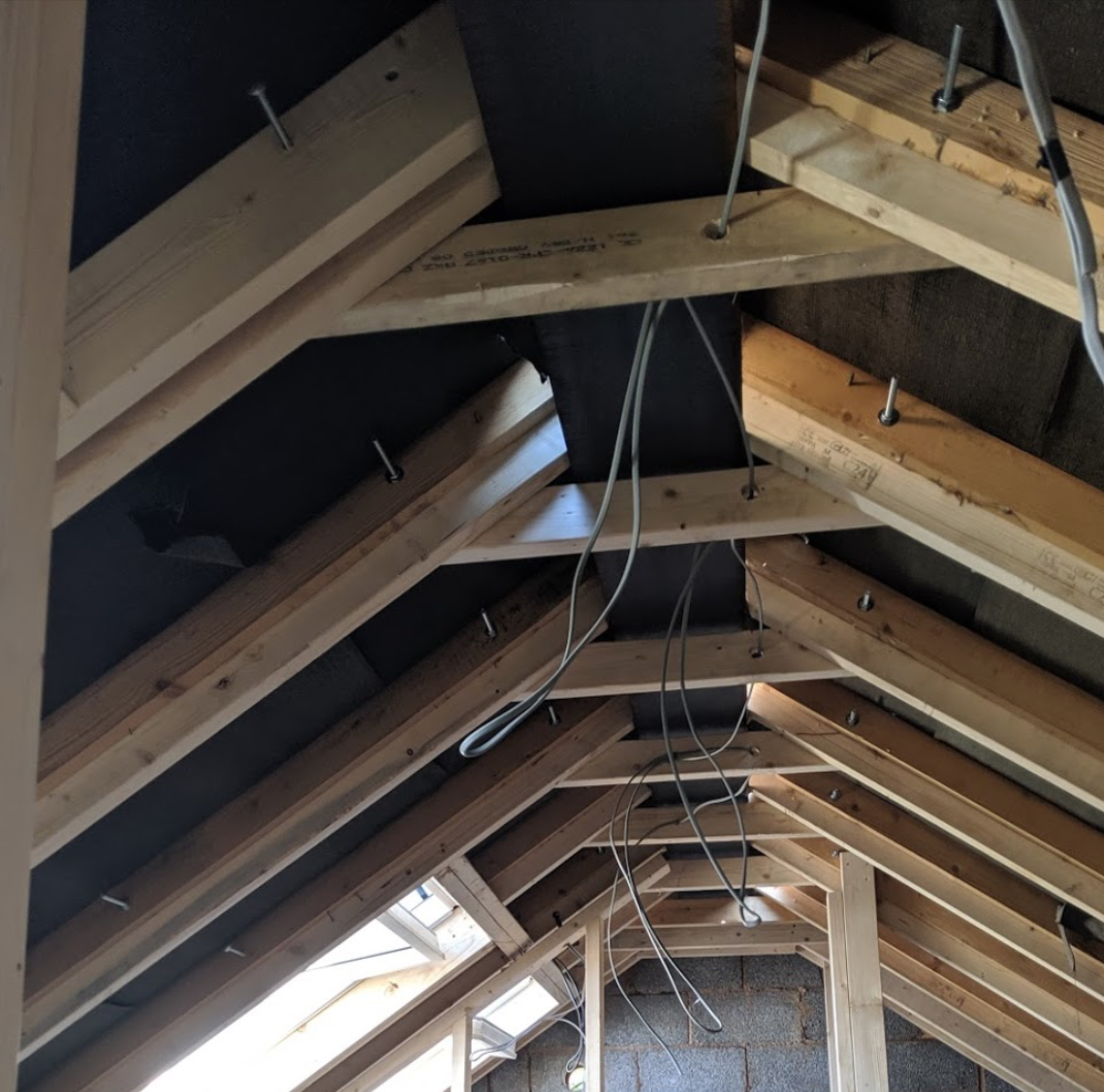

The really annoying thing about all of it, is they installed it too high because they installed huge 9x3 floor joists which brought the floor up massively. The loft was about 2.79m (truss style) originally, and now the final height is about 2.05m including increase in ridge height.

@op; what size ridge beam has the SE specified, and what is the span of the beam?
If you started with a height of 2.79m, and now end up with 2.05, that is a hell of a lot to loose for the floor and ridge/roof.
Did they put the floor joists between or above the bottom chord of the trusses?

The Ridge beam has got to be about 20cm-25cm wide and probably the same height (I've attached the best photo I can find)
The span is about 7.8metres onto the brick work.
The floor joists are hung off the floor steels and are just above the original ceiling joists.
They told me the first floor was just thermalite breeze blocks and the ground floor was the only load bearing wall, which is why the steel needed to go in.
I mean that all sounds reasonable to me, so no reason for me to question it.

The beam is then probably one of the 254mm x 254mm sections which is done in several different weights per metre; probably the optimum section-size for a 7.8m span gable-to-gable.
For the floor beams, it is customary to get them as low down as possible between the existing ceiling joists (Strictly not ceiling joists but rather what would have been the bottom members of the trusses). The joists are then supported by hangers off steel beams each side running gable-to-gable.
