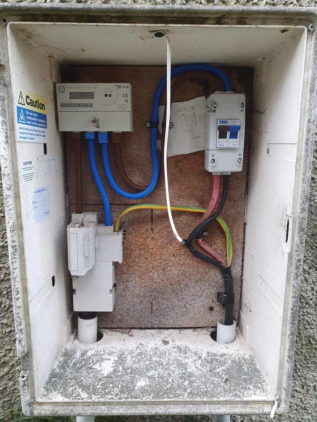

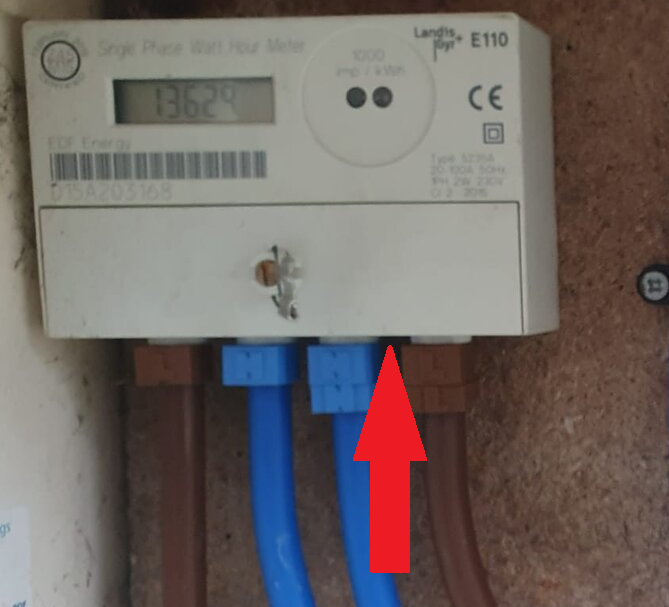

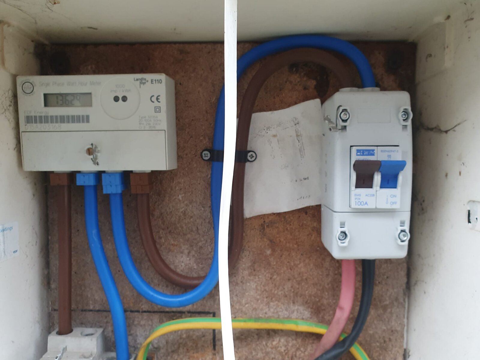

Hi, I cannot work out how to get a peak reading from my electricity meter from a house I have recently moved into. The setup is shown below. The meter is a Landis+Gyr E110. The display cycles through two numbers - one shows a number currently around 13600, and the other shows the default test screen i.e. with all lights lit up, 8888888. However, the supplier requests two readings, and the final bill from the previous supplier has a peak and an off-peak reading on it. From comparing the number on the screen with the final bill from the old supplier, the number shown on the screen is the off-peak reading.
I cannot see how to get a peak reading. Is there a way to cycle through the peak/off-peak readings on this meter? I can't see any buttons. There are two lights on the meter. The manual for this meter is not helpful. Is it possible there is another meter somewhere else on the property with the peak reading? There are also two switches on the right but this is a Proteus AC228 100A isolator switch so I presume unrelated to the meter, and I haven't touched them.
Contacting the previous owners is a bit tricky so I thought I would post here first in case there is something obvious I am missing. Thanks!

No.
That is a single rate meter, the only reading is the one you have already got.
You do not have E7 or any other split rate arrangement - everything through that meter is on a single rate.
Check that the meter serial number (below the barcode on the front of the meter) matches the one that is on your electricity bill.
If it matches, then the supplier is in error and believes you have something that you do not.
If it doesn't match then either that is not your meter, or it has been changed and the supplier was not informed about the change.

Desperately unlikely.
Old E7 arrangements did have two separate meters, one for day rate and one for E7, but that is not the case here, as there would be another cable from the meter cabinet into your property. You only have one and from the red/black colours of it it's been there for several decades.
99% this is an error by the supplier, or they have been given the wrong metering info by someone in the past.

No need.
You have a single rate meter, and need a single rate electricity tariff from whoever you choose as your supplier, starting with the reading displayed on that meter when you moved in.
Previous blunders are not your responsibility or concern.

The SIMPLE way to tell that is if there is a terminal for another wire in the bottom of the meter
then it will be a dual rate device, if no additional terminal then it will only be single rate.
The SIMPLE way to tell that is if there is a terminal for another wire in the bottom of the meter ... then it will be a dual rate device, if no additional terminal then it will only be single rate.
That would certainly have been the case in the past. However, given the way in which dual-rate tariffs work these days, is it necessarily still the case that the meters offer a switched 'off-peak tariff' output?
