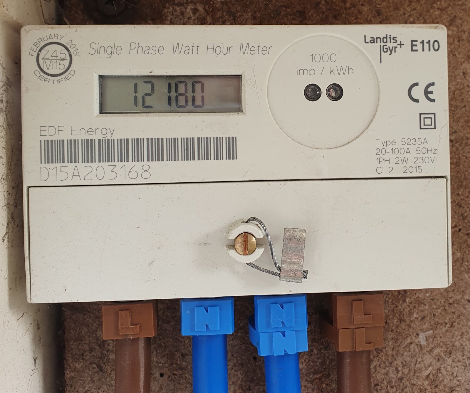

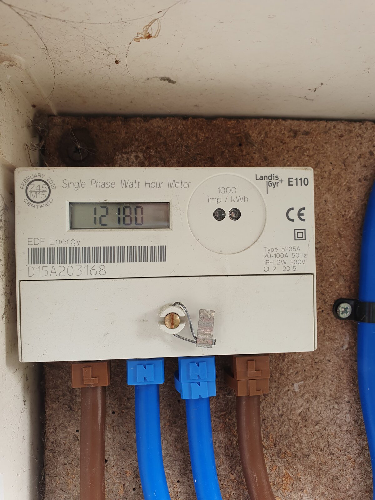

This is a better photo of the meter:

The SIMPLE way to tell that is if there is a terminal for another wire in the bottom of the meter
then it will be a dual rate device, if no additional terminal then it will only be single rate.
Will have a look for this later, thanks.
Just to add to the confusion, the post #16 pic shows two L and two N designators on the outputs from the meter!.
I'm not sure that is 'confusing', but it is unnecessary overkill (perhaps for the benefit of the colour-blind ?!). Indeed, the tails commonly have no 'designation' at all!
seems to be standard for things done in the last 5ish years or so: 1's on the in, 2's on the out, 3's of the second rate or tarriff control. Or simple 1-4 or whatever from left to right.
