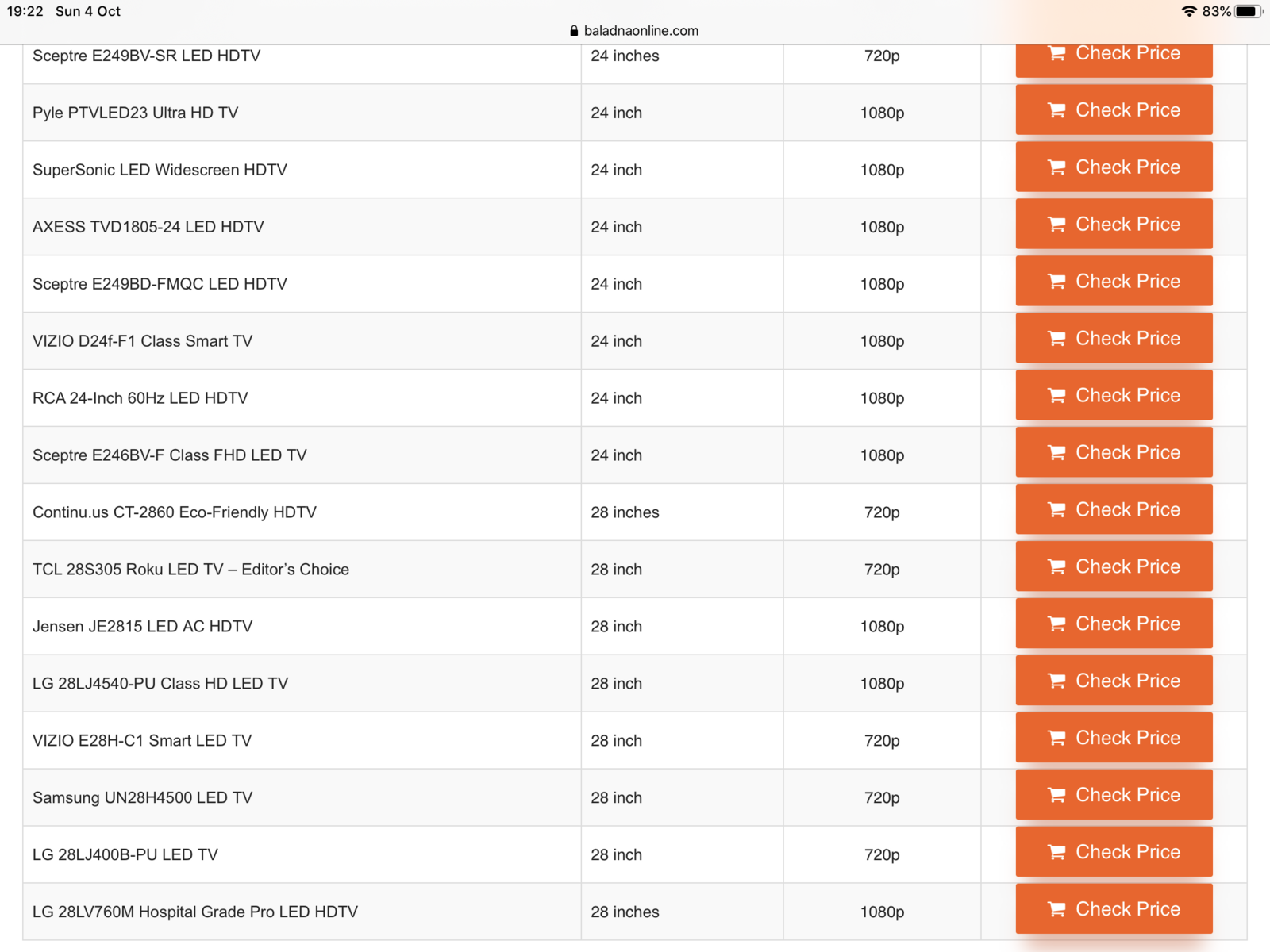

I am after a new TV that meets the following specs, can anyone help me find one:
  • Resolution is 1920 x 1080 or Greater. (i.e. Not 1366 x 768)
  • Has a built in digital terrestrial tuner
  • Is 27" or 28" in size
  • Is new/current model.
Regards: Elliott.

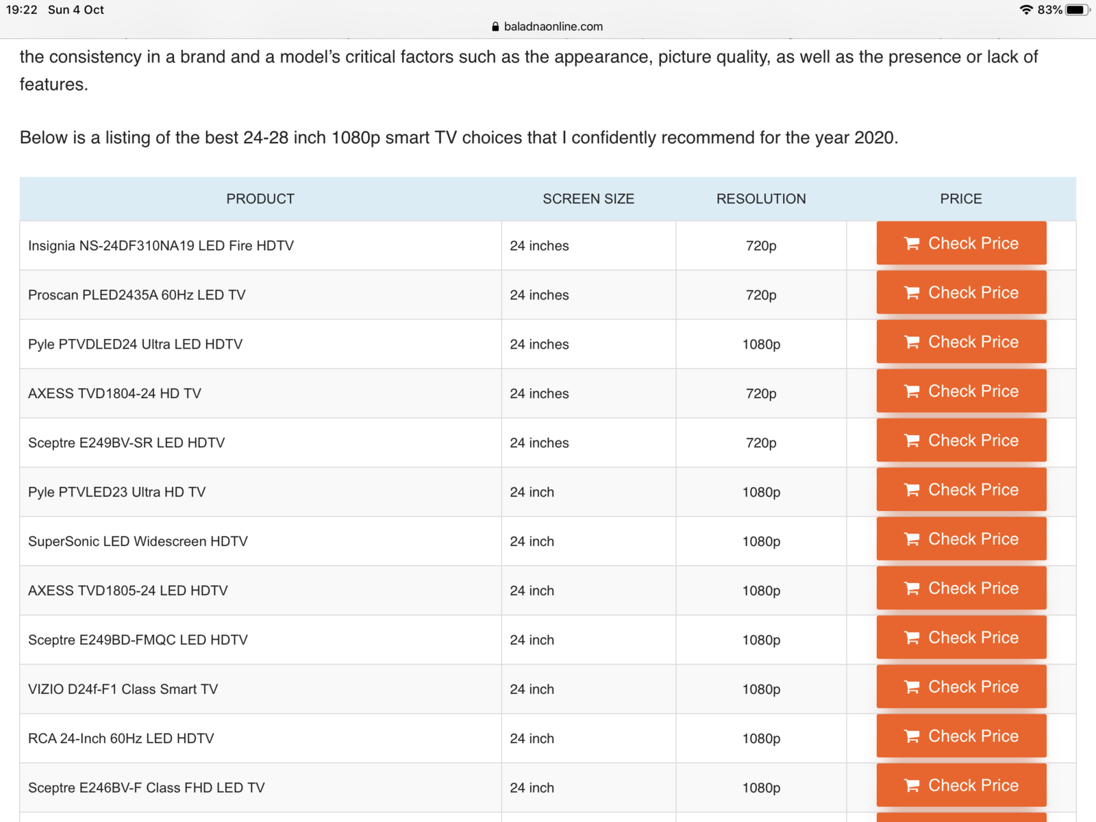

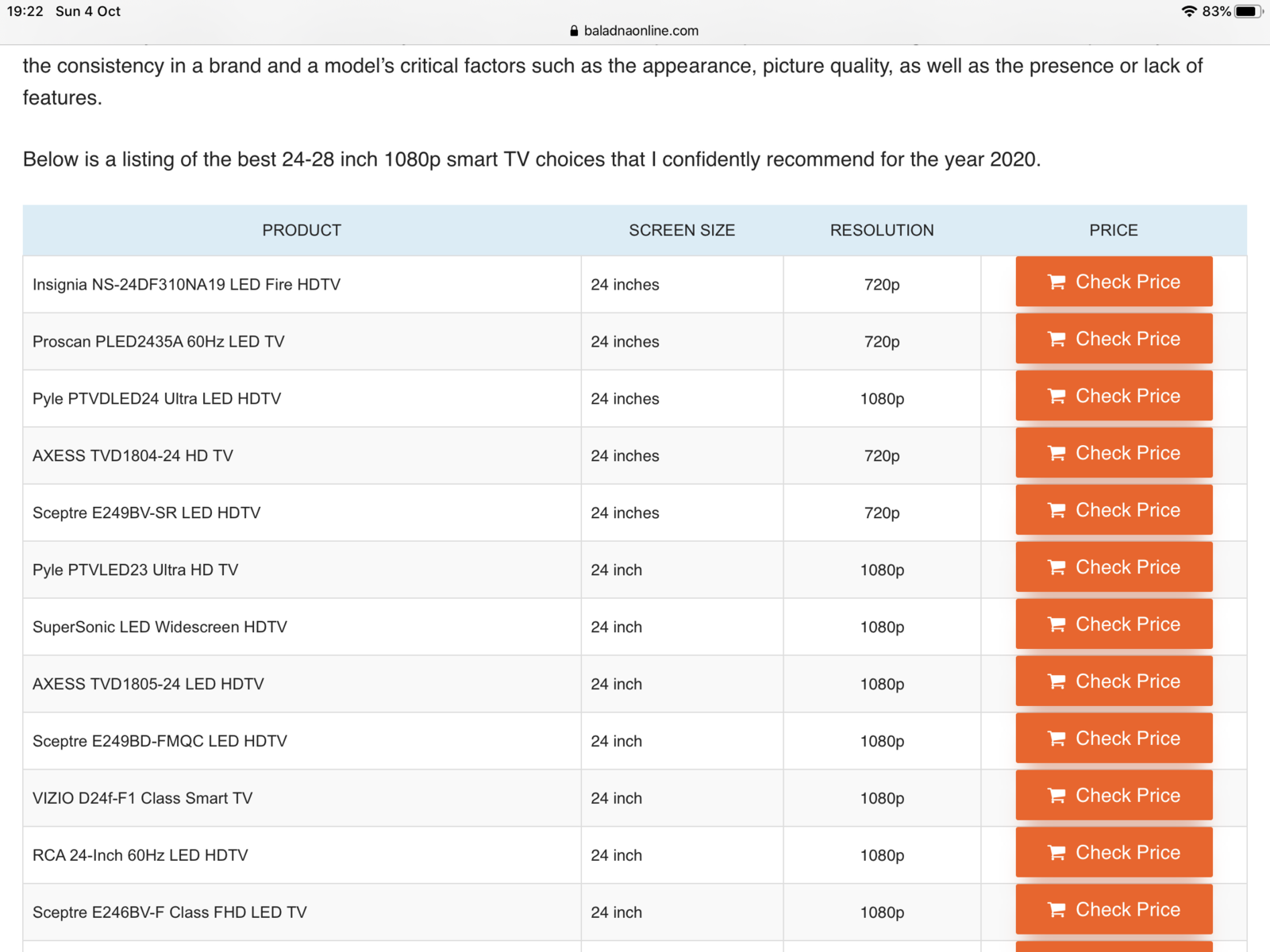

Looks like your f***ed ...maybe this may help ....looks like the major brands don’t do that combo .... ECD6B278-FA08-423E-86EB-6267A5C7BEF7.png5AB2464A-8B7B-47E3-8635-9C5286BEB887.png
But they are all of the 1366 x 768 resolution. I am after 1920 x 1080.
