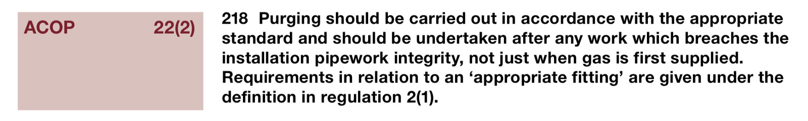

Then you shouldn't be paying for someone to come and light your boiler, unless it was defective in the first place. Under the gas regulations he has a duty of care to purge and relight.
That's brilliant. Thank you. Where did you get that from?
I suspect the boiler is defective as couldn't light myself. But this bloke didn't even try.
