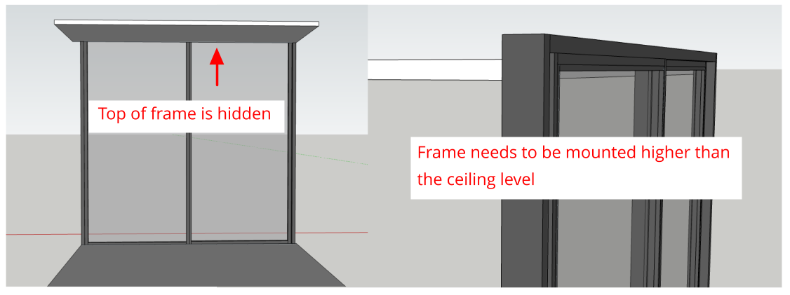

Due to my design requirements I need the top frame of the S door to be higher than the beam.
Could this be better addressed by using a shallower beam
These are the issues I have to deal with
1 The extension limits the height of the structure to 3mtrs. The original kitchen is stepped down to so I want to raise the floor. Add that to the level of the ground out the back being again lower I am very limited in ceiling height head room. I cannot just lower the ceiling.
2 Its a cold roof and the beam is calculated already. At 225 tall is not really big
3 To get the frameless look the sliding door frame needs to be mounted ~60-100mm higher than the ceiling level see image

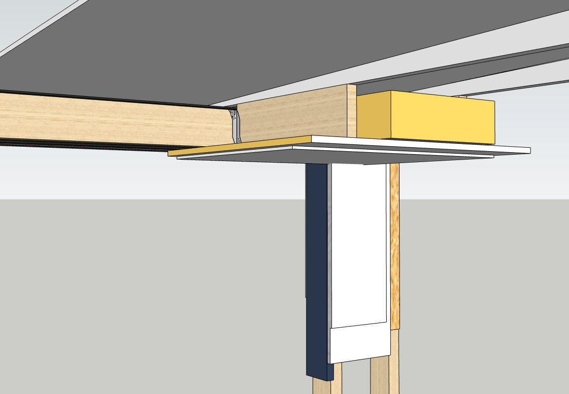

I'm pretty sure now that the bolting of 200mm of timber to the frame is the solution. The timber will be also supported at each end by the wall. This will reduce greatly any twisting motion
Could you fix through the deck which would have a cantilever support effect in addition to any brackets in the web
blup
The design is now such there there is not much cantilevering. What there is is being taken up by the bolts which I may add to higher in the beam web. If need be I can add a strap across the from the joist to the blocks. I also have to factor in a hidden gutter system.
Personally I would not use the decking to counter the leverage forces.

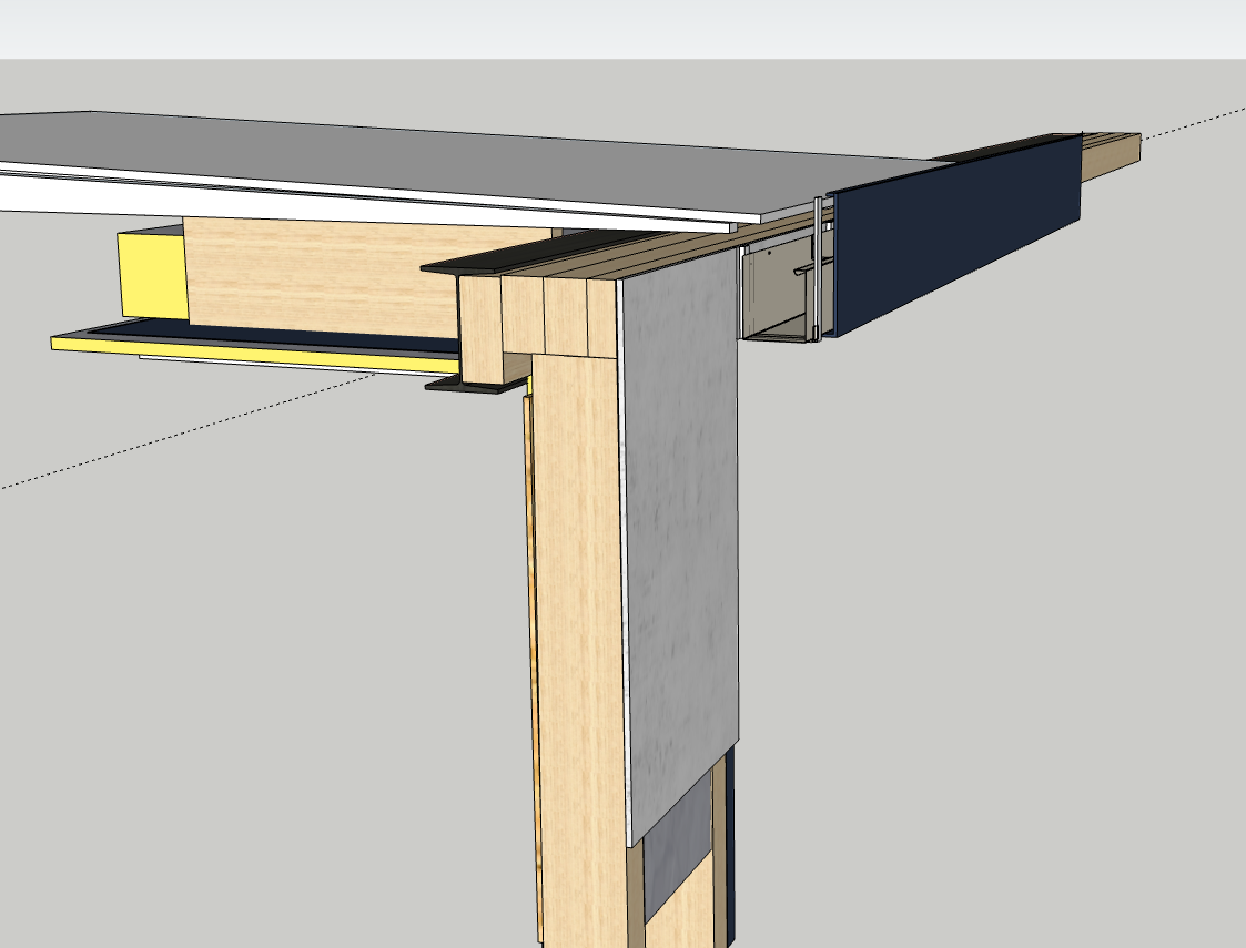

The design has moved on now the claterlivering is now just about done. I have all the design now sorted including the guttering behind the facia
Could probably do away with the steel now you've got 5 glulams compounded together over the doors; the roof structure doesn't appear to be particularly heavy
Also reduces the thermal bridge problem the steel introduces
If you're keeping the steel, insulate the top flange as best you can
