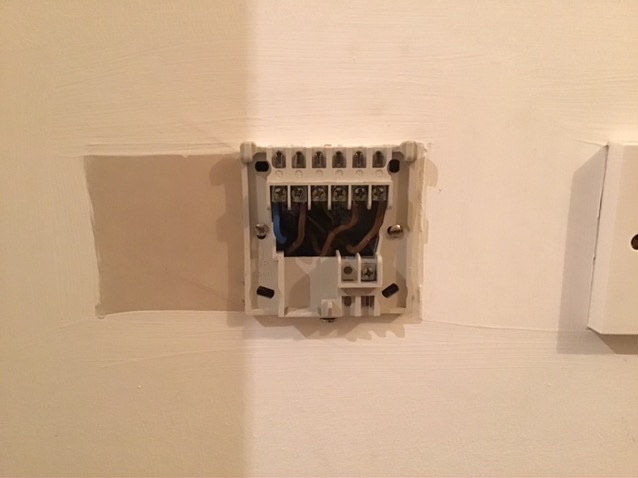

I took off the front panel of the Grasslin and there’s no wires connected to the HW OFF or CH OFF. Picture attached.

As you dont have HW off wired in it sounds like you have an S plan so you will have 2 x 2 port valves, try and find them and post pics of which ones you have
Does not need wires to off connection.

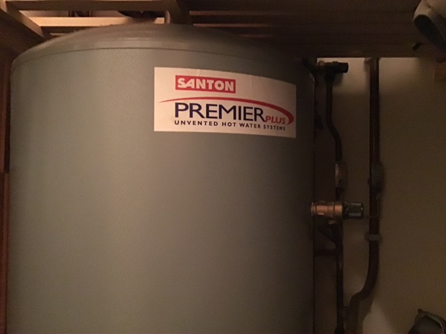

Almost certain there will be two two port valves as one is always required for unvented cylinder

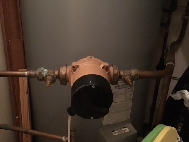

Suggest you also find out why you have 2 pumps installed.
Is this a particularly large house?
What does the cable for the yellow bodied pump connect to at the other end?
Think it is a Bronze secondary HW circulation pump, havent actually seen that exact model before though

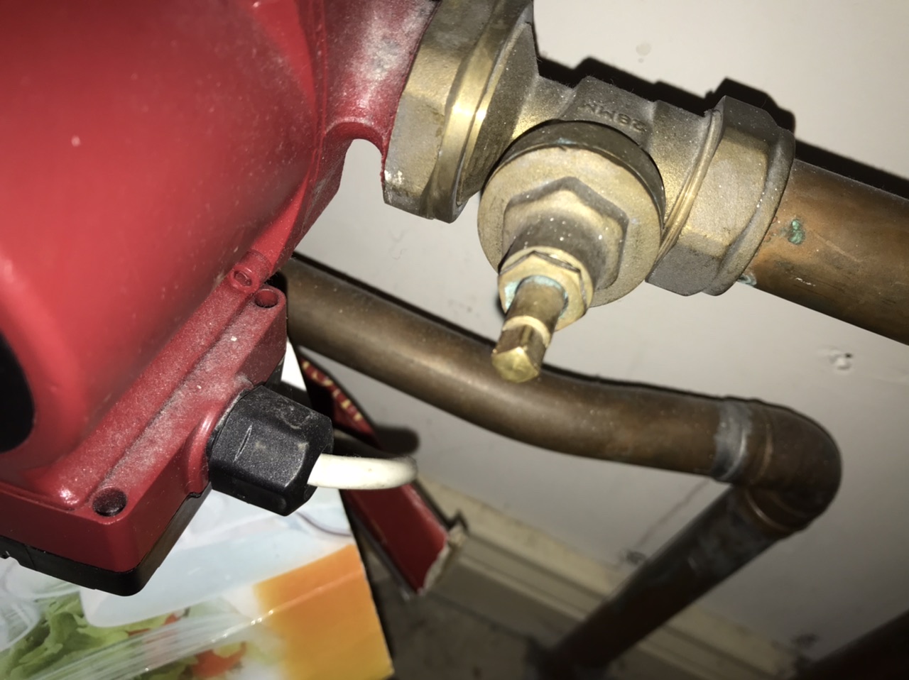

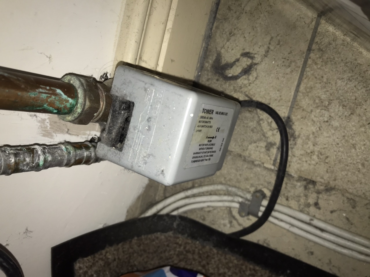

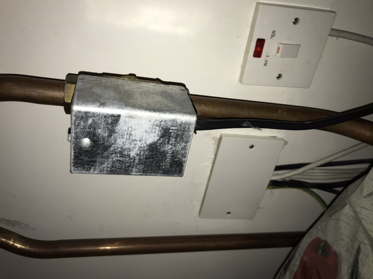

Hi all, thanks for helping out already. I’ve snapped what I think are the two valves. The house is not a mansion or anything, it’s a 4 bed. The yellow bodied pump I can’t really tell where or what it’s connected to. If seems to be separate from the red pump though and it’s on the opposite side of the hot press.

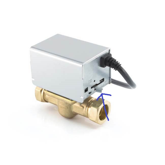

Yes that is what you are looking for, one of them is faulty, there is a small ever on the end of each valve, this is for putting the valve into manual position, with CH and HW both turned on these levers should be able to slide across but should show a resistance, with the CH and HW turned on and any thermostats calling for heat they should be very easy to slide across, try that, it sounds like your CH one is jamming open or letting by

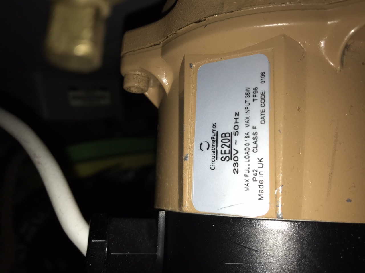

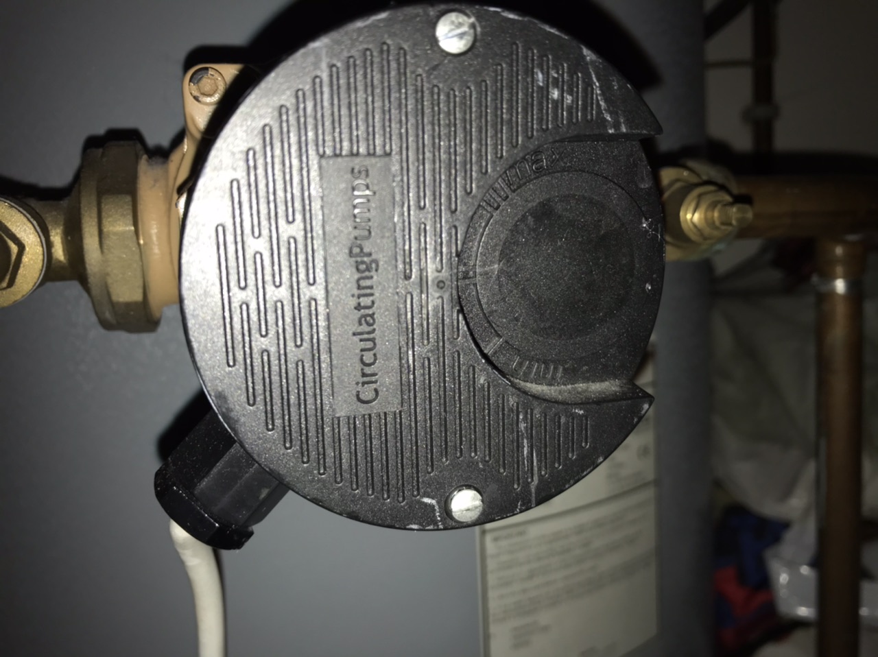

on your yellow pump there is writing on the black plastic, would you be able to get a better pic or tell us what the writing says , as in pump make and model number
In your pic with the zone valves it looks like your electric Immersion heater is switched on, this is for emergency back up if your boiler fails and it shouldnt be on

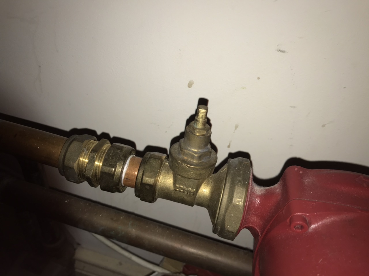

Immersion switch is off now! I’ve snapped a couple of pics of the yellow pump. Are these other photos the levers that you mentioned Ianmcd? I don’t see anything that looks like a traditional lever, except on the opposite wall coming out of the small red water tank in my first post. Thanks everyone for your help!

The yellow pump is indeed a secondary bronze circulating pump as suspected, the levers that you are looking for are at the end of the silver boxes, on the zone valves, not the pump

Yes, as you suggested Ian this appears to be the issue. One of the levers had jammed and wouldn’t move. If I have someone who knows what they’re doing replace this, would it possibly fix both my issues of not being able to separate hot water from heating and that there is never enough hot water for baths etc?

Yes , I think that you were heating your HW with the Immersion heater , which doesnt heat the whole cylinder, and that the jammed actuator is the HW one, get the jammed one replaced, and come back on if it doesnt solve everything ,and I will help you some more
