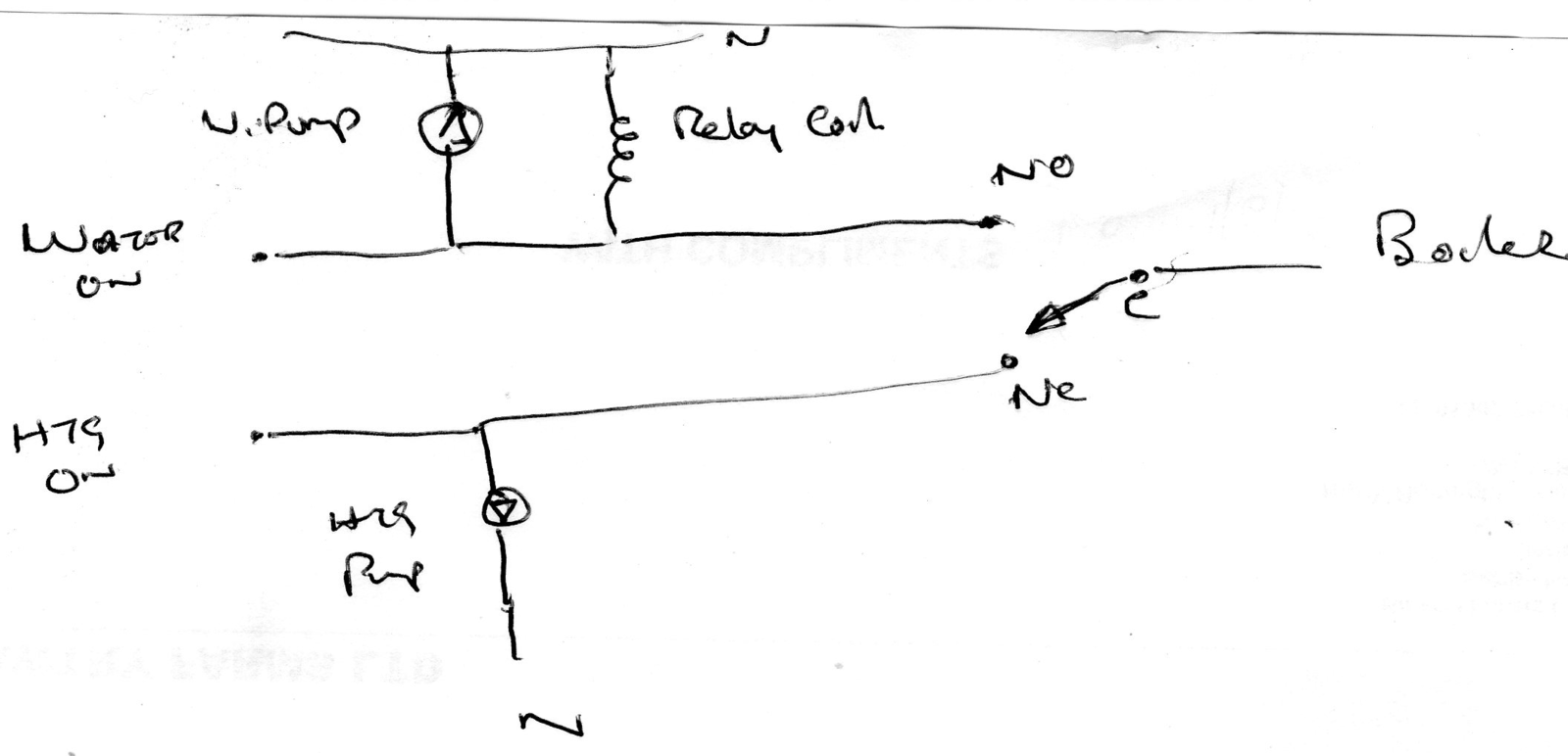

Then it occurred to me that, as I said, with a dishwasher and electric shower, I really don't need hot water at all, so why not just turn it off... figured the easiest way to do that was simply turn the pump to the tank off (I have two separate pumps, one for hot water, one for the rads. So I turned it off, and the burner stopped burning...
Turns out I can turn the rad pump off, and the burner/boiler is happy; turn the hot water pump off, and it stops. Unless it's possible for me to get it rewired in some way, guess I'm stuck with constantly heating a tank full of water I don't need...

You might be interested to know...
in summer when I am using gas to heat the cylinder (no central heating), my average gas usage is
0.75 cu.m/day
8.4 kWh/day
22pence/day
plus VAT and standing charge
This includes showers and some baths, and some washing up. We have a hot-fill washing machine so this cuts electricity costs but increases HW use. The boiler is timed for an hour in the morning and an hour in the evening. Even if it was fully cold it would be hot in about half an hour, after which the thermostat stops the boiler trying to heat it. So yours is actually not being heated for several hours a day, unless for some reason you have chosen to have an uninsulated cylinder and unlagged pipes.
If you were just using HW in the kitchen sink and to wash your hands yours would be less.
Energy from electricity costs about four times as much as energy from gas.
I can't see that your electric shower is a money saver. If you stopped heating your cylinder you would save a matter of pence per day.
Have a look at your summer gas usage records.
If you do get an electrician to look at it, depending how difficult the cable run from the airing cupboard is, adding a cylinder thermostat is not complicated and would make for significant savings.
