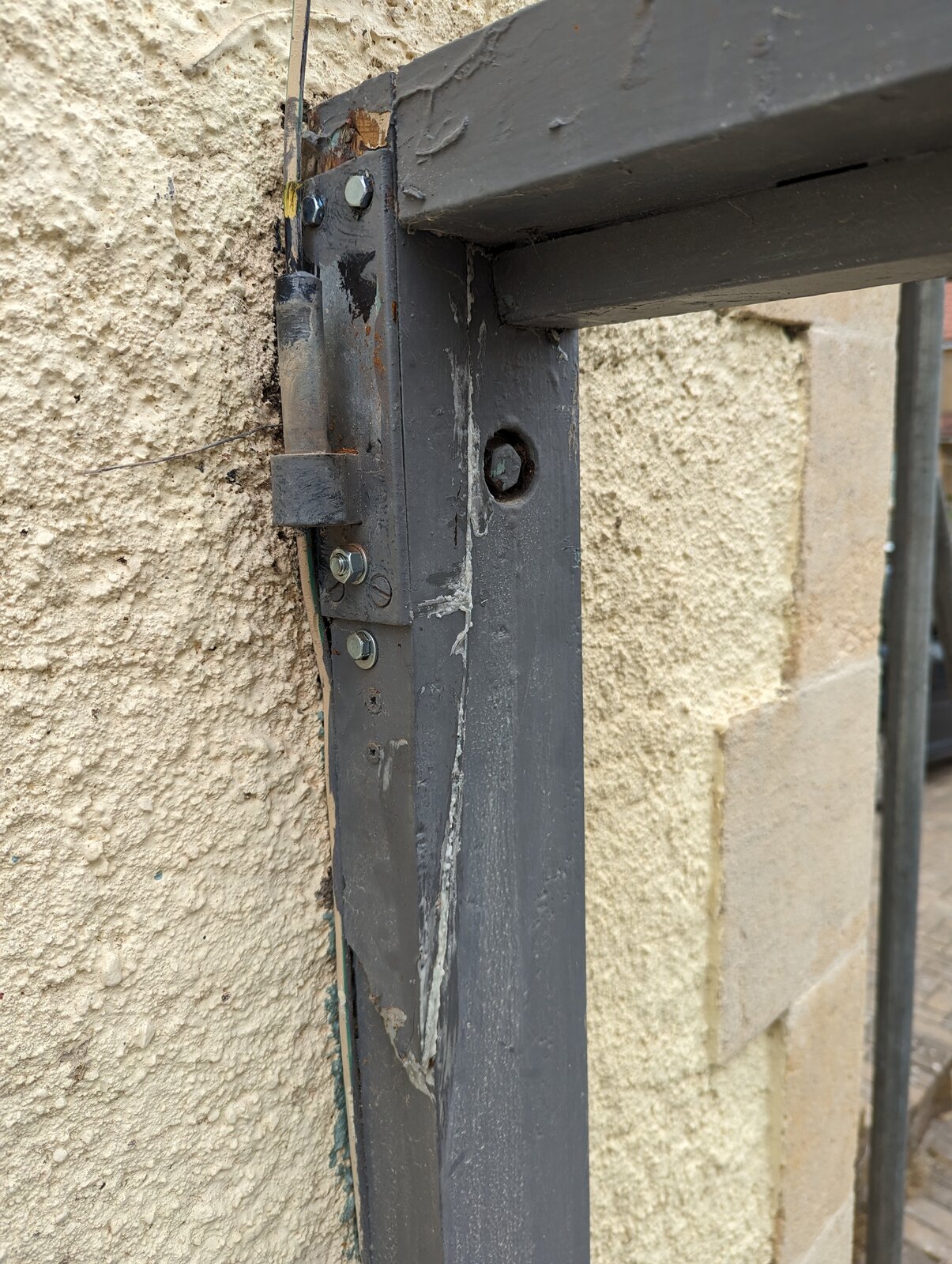

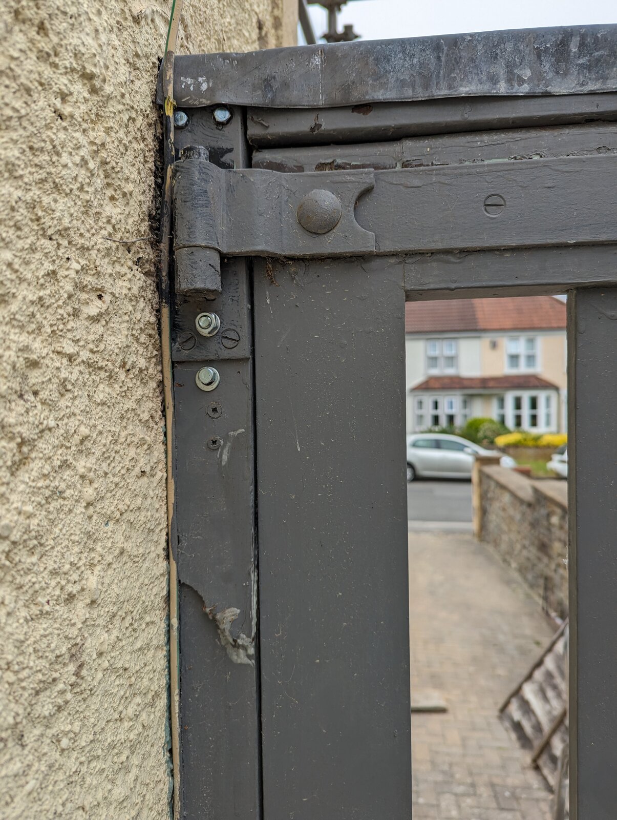

I've had a bash. It is ugly but it is working well: the split is closed and the bolt is now cleanly sitting in the socket. Thanks everyone.
I used a combination of the suggestions because of 1. the hardware I already had, and 2.the issue that I couldn't place a bolt at the top end of the hinge because it would get in the way of the door dropping into the hinge.
Therefore I glued and clamped, I put a carriage bolt through the lower part of the hinge, and replaced the top 30mm hinge screws with 80mm screws and put another one through the wood under the hinge.

Good work.
For little extra cost, and less effort, you can fit a new post next time. You will wish you had used stainless bolts.
(Edited) I like your bit of lead on the top to keep the rain out.
Good work.
Tack a bit of DPC, or lead, or roofing felt to the top to keep the rain out.
In one of the images from post #5, there is lead, but it is not visible in any of the other photos.

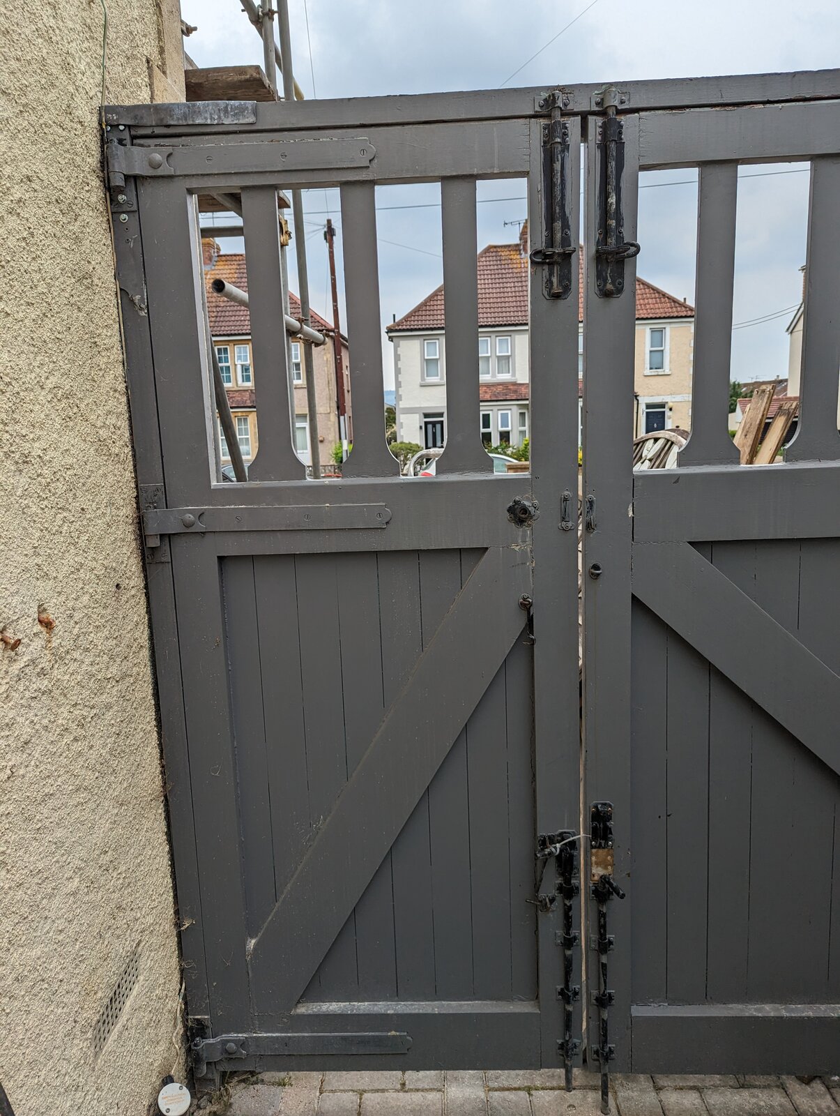

I only noticed a few months back that the top of the horizontal rail is totally unpainted. It looks like there was previously another piece of timber or similar cap fixed across the top for protection , but no idea what happened to it.
As a temporary fix I have put some spare lead at both ends of the rail (protecting the joints which look a bit weathered). Come payday I will buy a roll of lead or lead replacement and fix it across the whole top.
