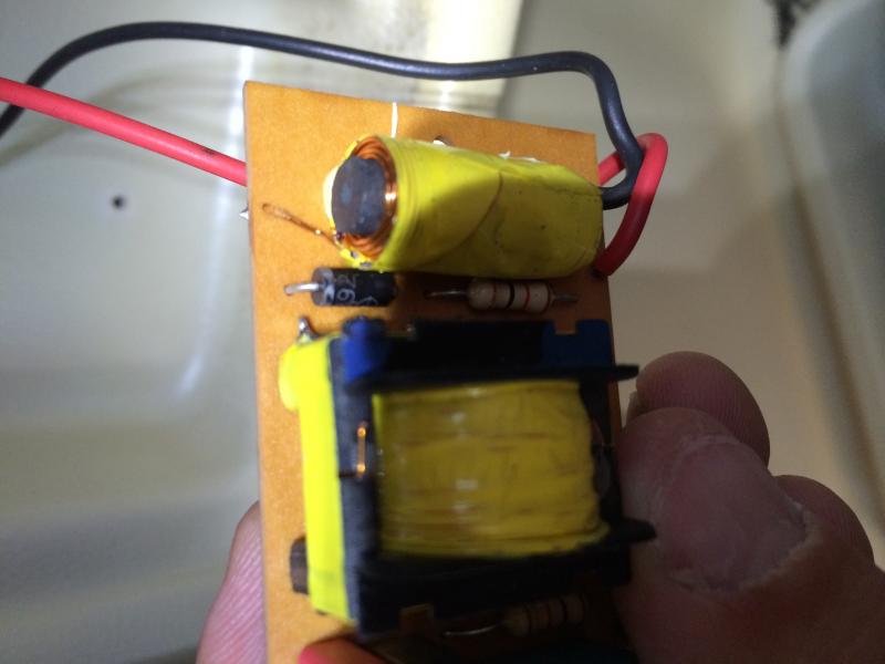

One of the lights in my caravan isnt work so i set about going to work with my multi-meter. I found i had voltage to the circuit board (pictured) but nothing coming out for the lighting terminals.
I did various resistance and Continuity checks and ive got a couple of questions about the pictures and the results i got.

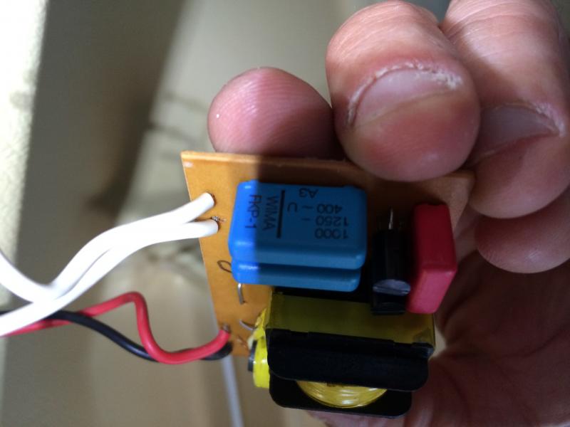

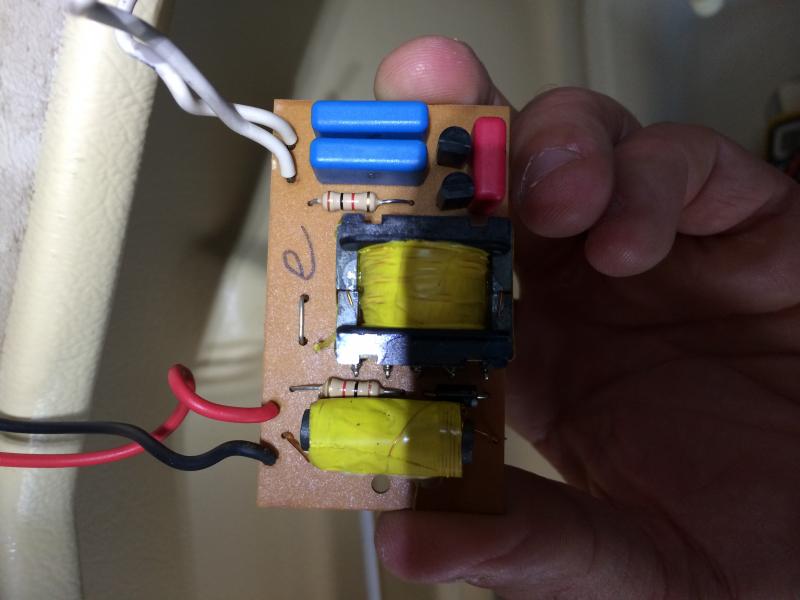

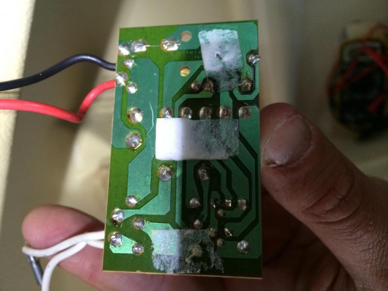

When I con checked the black thing in the 4th picture (not sure what it is as i cant see any values on it, look resistory shape but obviously isnt one) it was Open Circuit. Also in the 1st and the 3rd picture, the blue things also resulted in open circuit. Im not sure what its ment to be as I can see any units of measure on there. The resistors and all other bits on the board all work fine.

The board is an inverter, converts the 12V DC to a higher voltage for the fluorescent tube.
They can be purchased, but would probably be a similar price to a complete new light fitting.
The 'black thing' is a diode, it would measure o/c depending on what you were measuring it with and the polarity of the test voltage.
The blue objects are capacitors and would also measure o/c with a continuity meter.
It can probably be repaired, but given the very low cost of the device, it will not be worthwhile.

I didnt realise it was a diode, i have a Diode test facility on my fluke so Ill check that out.

I tried both AC and DC at the output as i thought it could have been an inverter but still nothing but i definately have 12vDC going in on the red line.
I'd missed the fact that it's cnnected to a flourescent tube.
As flameport said, it's an inverter. It converts the 12V DC from the battery to a couple of hundered volts at a high frequency.

I can see two transistors two coils two resistors and one diode and three devices which could be capacitors but could be something else.
So likely something like this
basic design but two resistors replaced with coils or transformers.
They have been made like this since very early days See Wikipedia but once they fail it is common for one component to take out another so to repair is like chasing ones tail.

The 12 volt florescent ballast comes in two basic designs. Early models used a tapped transformer which took the AC supplied from the Multi vib and transformed into approx 7 - 80 - 7 volt once the tube fired this would drop to around 3.5 - 40 - 3.5 volt the heaters getting 7 volt at start dropping to 3.5 volt once fired up which resulted in a 8W tube taking around 12W much better than tungsten and the electronic noise was quite low but latter models did away with the heaters with a before strike voltage of around 180 volt and after strike again 40 volt this would seem more efficient but in real terms very little in it as the components ran hotter.
For the larger units there was a move to a full switch mode system so 20 W tube used 20W but even today the 8, and 16 W have a very basic design and produce loads of electronic noise as well..

To check a diode you'll need to remove it from the board first, forward biased it should measure 0.7v and reverse biased OL.
The choke next to the diode should just read a resistance with a fluke.
