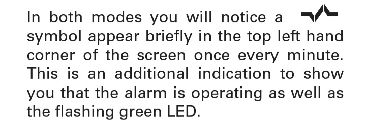

The green flashing light is normal operation and shows that the detector is active.

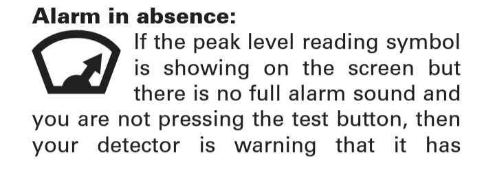

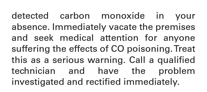

I keep pressing the button even with no fire on and that icon keeps appearing

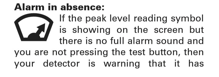

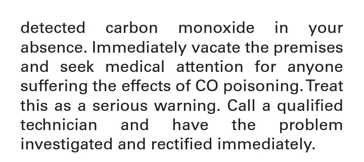

The icon shows that a high level of CO (probably 33ppm), was recorded in your absence:

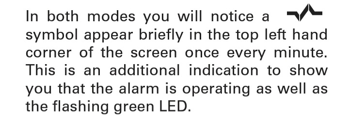

Very confusing this if it is a flashing green light and the icon means dangerous.
The green flashing light is there to tell you the device is operating correctly.

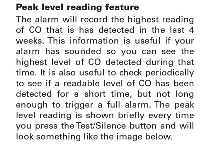

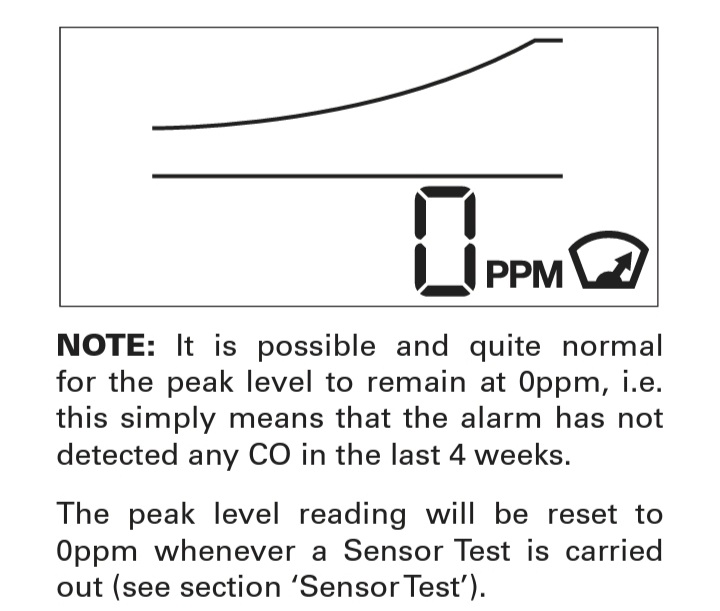

Pressing the large button sets the ppm from 33 to zero.
You are not resetting the counter on the device - you are changing the display mode between a real-time display of the CO and the peak amount previously detected (within the last four weeks).
You need to get your stove (and any other gas appliances) checked by a qualified person.
Make sure any vents that you have are open and not blocked.

Ok, I took it from your photo and description, that the symbol was being displayed continuously.

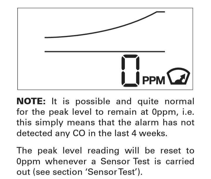

In which case, it is displaying the peak CO reading recorded in the last four weeks. It displays the reading when you briefly press the button to change display modes.
Again, from the manual...

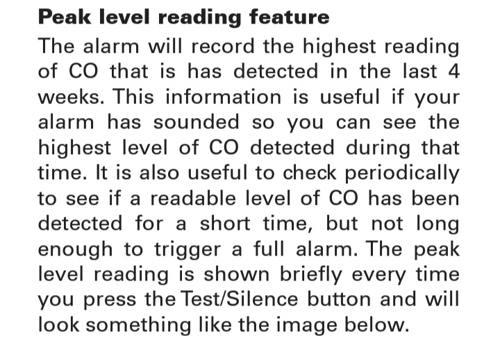

As mentioned, that is a peak reading for the last four weeks. Unless a new reading peaks higher than that, the display will still show 33ppm, until four weeks have passed since that peak reading was recorded.

What the detector has shown is that there may be a developing problem, that needs to be addressed.
It has warned you that the CO concentration has been raised, but at levels that will not currently cause harm.
