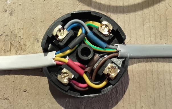

The requirement was all sleeves to be brown but old cable colours were permitted.
So a red/black was ok for L&N but brown sleeve on black for SL.
... So a red/black was ok for L&N but brown sleeve on black for SL.
Yes, but presumably with the L still red. That's what seems odd (mixed conventions in the same cable) and what I thought might well not be allowed.
Kind Regards, John
Yes.
Sorry I was typing when yours came in.
But in places which had not been altered the red sleeve remained and a silly situation arose (and we refused point blank to change it) where in a 2g switch, we converted one to 2 way so the new harmonised cable and the existing black were sleeved brown but the remaining (unaltered) switch was identical but black sleeved with red.
We refused to change it as doing so would have meant we had to take responsibility for the circuit.
Kind Regards, John
Yes it felt totally wrong and counter-intuitive. The regs were trawled by others further up the chain (not me) and apparently is reads 'sleeve with brown'
I thought Red was still a recognised colour for live, so although odd, Red and Brown is ok, though as said id mark both Brown.

And for exactly that reason I don't understand that people mark black and grey cores with brown sleeve.
I suppose that depends upon what you mean by "recognised". It is still accepted as identifying Line (or Line 1 in 3-phase) in 'old colours' (or mixed-colours) installations, but it is not recognised as identifying anything in terms of Harmonised Colours .
That fortunately means that there can be no ambiguity, since red must relate to old colours - so I suppose it is not actually a 'problem'. It's black which is, at least theoretically, more of a potential 'danger', since there is ambiguity - without context, it could mean 'neutral' in old colours or L2 in harmonised ones.

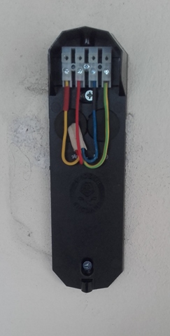

The sleeving question came up on another electrical forum the majority sleeve as below:
A wall light I fitted a few months ago:
I would never mix new sleeving on old cables.
For a single phase circuit connected to a 3 phase supply, the line conductors should be brown. It used to be common for single phase line conductors to be the phase colour when wiring in conduit and trunking but apparently no version of the regulations permits this. It does look cool though...
The sleeving question came up on another electrical forum the majority sleeve as below: ...
That's certainly how I would do it. Like you, I would never mix new and old colours on the same cable.
That seems to be how things are now done. However, if (I imagine very unusually) a cable carries line conductors for single phase circuits on two different phases, it would seem sensible (and 'safer') to identify them with the appropriate (brown, black or grey) phase colours.
Kind Regards, John
