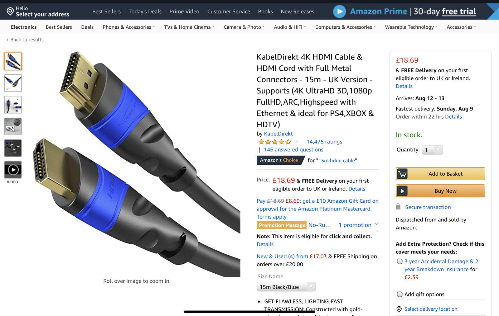

I hope you're not going to try to run 4K over 15m of plain copper HDMI cable.
Err, I was. I’m not expecting 4K quality, just an easy HDMI connection from my cctv to my TV. I don’t have any connection at the moment, I just view the CCTV on my phone or iPad. The current connection from the cctv to my router is via a powerline adaptor with the router end on the downstairs ring main and the cctv (which is in the loft) adaptor on the upstairs ring main. I was kind of hoping it would be as good or better than that setup. I have a spare tv in loft that is connected to the cctv by a 1m HDMI for monitoring and setup purposes so before I go running the 15m cable all round the place, I was thinking to just replace the 1m one with the 15m one to test it first. If it’s no good it can go back.

I hear what you're saying about viewing the web page for the CCTV, and I'll come to that shortly; but the immediate question which is very important is "do you really need to send a 4K UHD signal down this cable?"
The answer is only Yes if all your cameras are native UHD resolution, and your recorder is recording from them in UHD resolution too.
If you're wondering, 'native UHD resolution' means that the imaging chip inside the camera has a physical pixel count of 3840x2160 pixels. A lot of CCTV manufacturers will quote MegaPixels for the resolution. 3840x2160 is 8.3 MP. For comparison, 1080p HD has a pixel count of 1920x1080, so it's MP number is 1920x1080 = 2 or 2.1 MP depending on whether it's rounded up or down.
Interpolated resolution isn't the same as native resolution. Where your cameras have a native resolution of less than 8.3 MP, but the recorder is outputting at UHD, then either the cameras or the recorder are taking a lower resolution image and scaling it up. This kind of up-scaling doesn't improve the picture quality or increase the image resolution though.
Bringing this back to your cable, if your cameras are 1080p native, and the recorder can record those images at the same resolution, then the best quality you'll get from the system is when the HDMI output resolution is set to 1080p. This will also help with the HDMI cable.
Currently there are no passive all-copper HDMI cables capable of sending a UHD resolution image at 50 or 60Hz over 15m. It may (and probably will work at 1080p 50/60Hz, but a UHD signal requires the cable to pass 4x the amount of data, and that's just too much for copper HDMI without some form of amplifier/equaliser.

Well, my cameras definitely and my dvr possibly are 1080p and I just thought that a 4K cable would be a better quality than a standard quality one that was only £4 cheaper. It was the gold plating on the ends that confirmed the quality to me......:whistle: :LOL:
Gold plating is a gimmick not a sign of quality. Pointless unless the sockets you are plugging into are gold plated as well.

Just to update, cable received today, bloody thick, thicker than the Cat5e cable. Temporary tested it by plugging into the CCTV in loft (across landing, down stairs, across hall and through lounge) and to TV in lounge. Perfect picture on a 42” screen, to my old eyes anyway. I only have 4 cameras in total, all 1080p so I assume that’s why I got away with it. Once fitted correctly we can now just switch to cctv at the flick of the remote instead of opening an app and viewing on phone or tablet. :)
