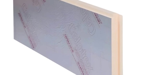

Were using the latest 90mm Unilin rebated stuff. Very expensive and shít to fit.
Hi,
We're looking at an extension and want to keep the walls as thin as possible. Why use expensive stuff (unilin is 0.021W/mK) when it is hardly any better than bog standard PIR (0.022W/mK)? Is using standard PIR with a 10mm gap a real challenge to build with? Cheers

Interestingly @noseall my builder has proposed 90mm T&G celotex in a 100mm cavity. Says he does it all the time and can mantain a clear cavity - reckons the snots on the outside skin won't be a problem.
