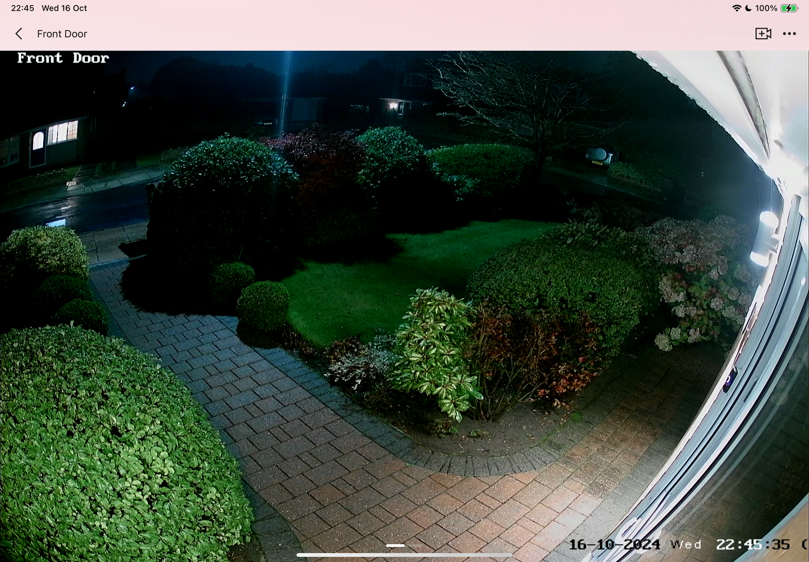

I’ve installed a number of systems for family members and friends over the past 5 years or so, and have used Hikvision and would highly recommend it.
It’s a professional brand and offer excellent choice of quality products, I’ve got their 5mp ColorVu cameras that give excellent video both day and night (in colour at night) attached image taken at 10:45 pm.
