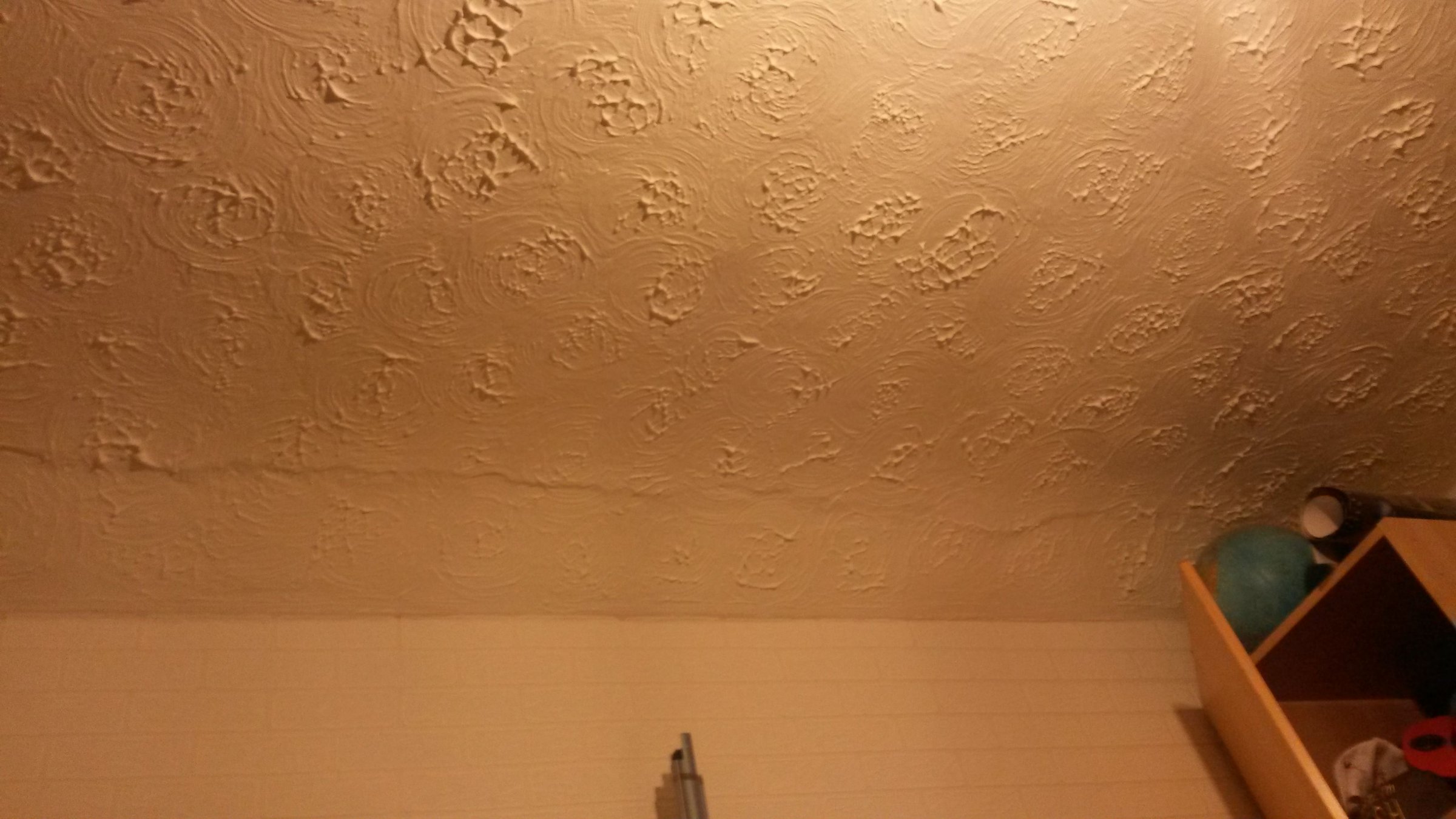

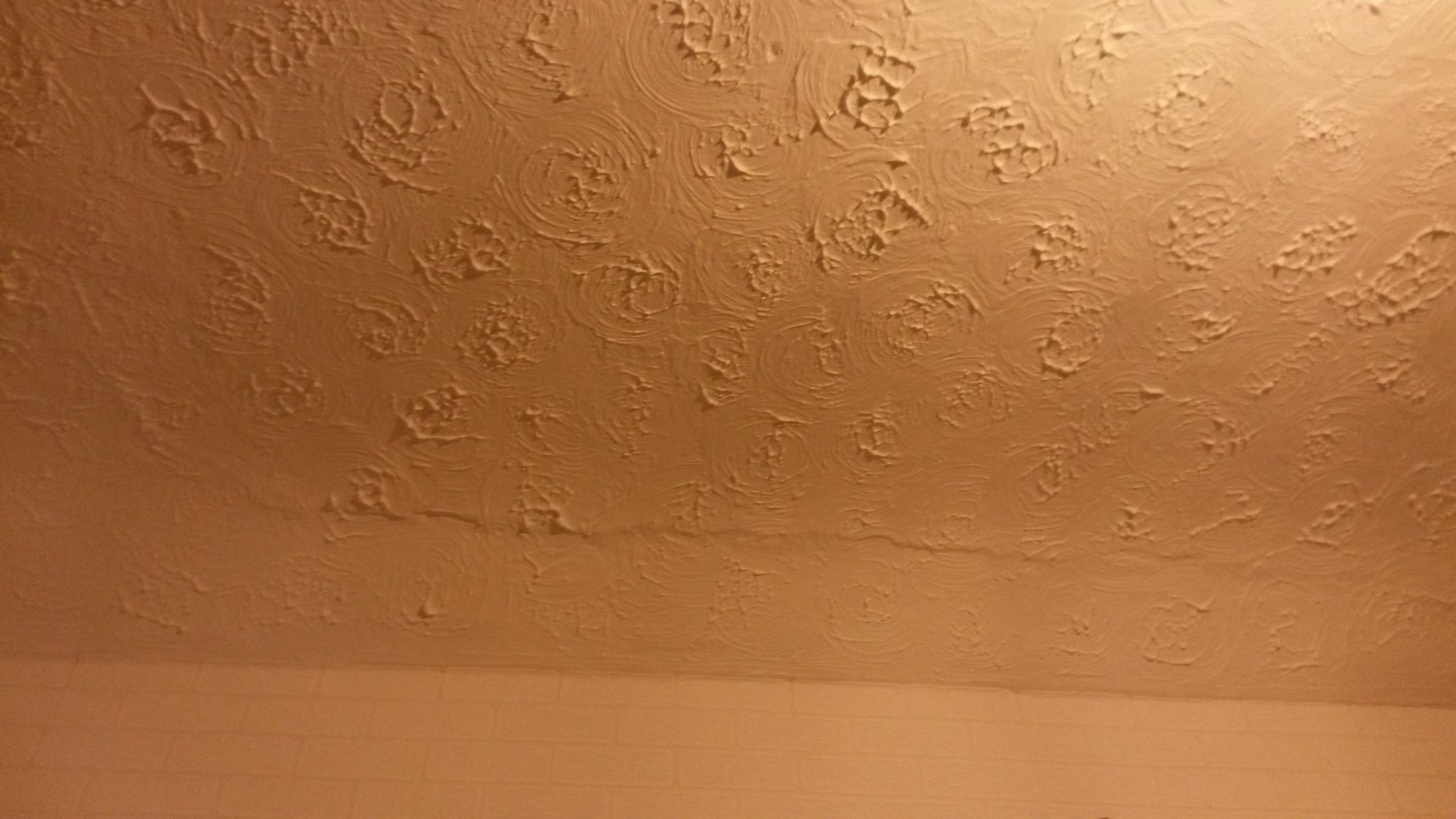

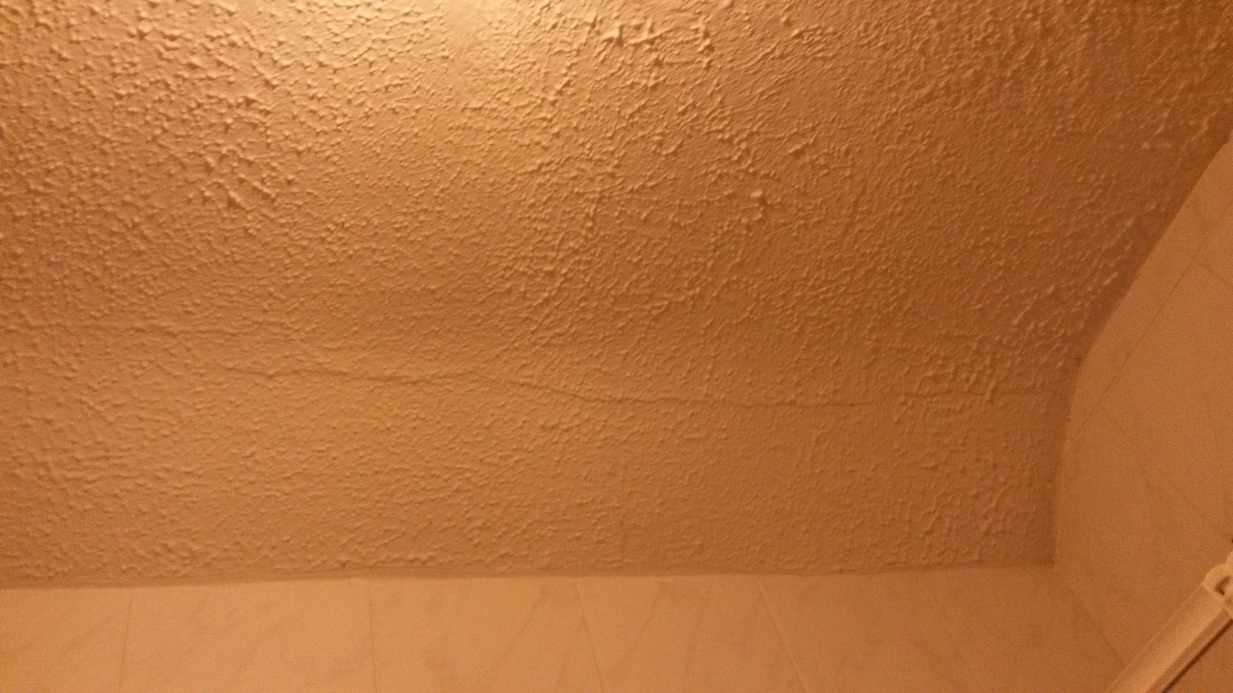

We have baught a semi detached from 1920 2 years ago and we have been traing room by room. Recently I have noticed what look like a crack under the artex in first floor bedroom. There is also small crack in the bathroom which is next to this room. One joinst looks like is bowing but not close to the 'crack'. My question shall be worried and contact structural engineer, or shall we just continue with tge renovation as normal. If is not structural what will be the best way to repair the crack and bowed joinst?
Thanks for your help
It's not structural, but tricky to correct. 1920's properties were designed to move and flex, so Artex was developed to try and cover over the cracks that naturally appeared. You need to check the roof outside and see if there are any leaks that would cause the ceiling to bow (assuming I've understood your post correctly) or get into the loft if possible. Assuming there's no leak, and the ceiling is bowing, it may be that the nibs on the ceiling have broken off, and if so, there are ways to correct this. The other alternative, is to re-board the ceiling, and then plaster it. But be careful of cutting off the old Artex, as some of it has aesbestsos in it.
Thank you for your reply, I think we will board the ceiling and plaster over it. The previous occupiers done some bodged jobs in almost every room.I believe they removed the chimney between this bedroom and bathroom, what possibly could cause some problems if not done correctly . As far as I know not recent leaks in the attic, do we need to put supporting connecting joints between stright and bowing joint?
How do we check if the artex in the house has asbestos in it?
Thank you for your help
A long as you're not scraping the Artex off, then don't worry about it, but if you ever do have to, make sure that you wear high quality breathing protection.
You'll use about 50mm plasterboard screws , and that should push the bowed section upwards. Screws are fitted every 6", so it'll all hold nicely.
If the previous owners have taken out the chimney breasts, check to see how far up they have removed them, as they may not have supported the remaining chimney properly.
