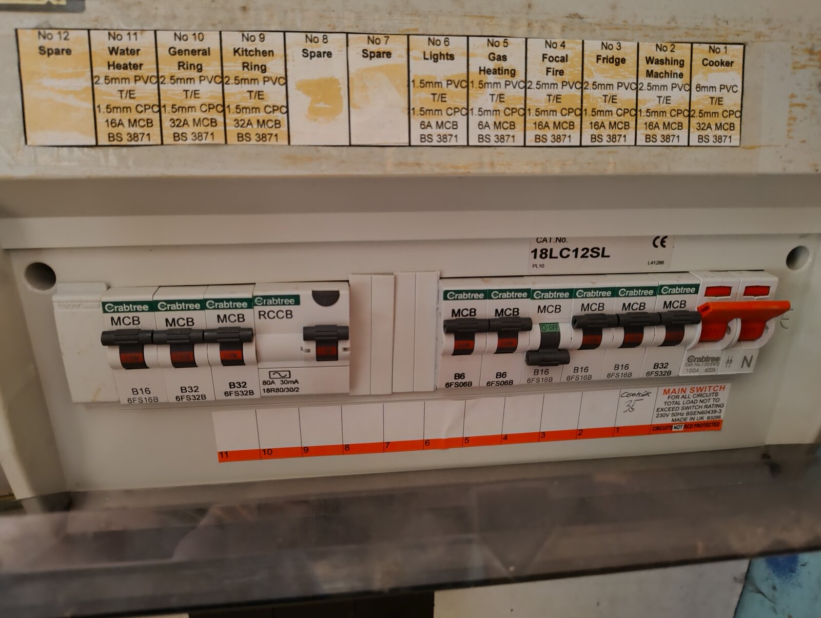

Q. Does your lighting circuit have an RCBO or alternatively an MCB and an RCD?
Appears to just be a single MCB for the Lights.
If you zoom in on the very bottom right, under the main switch, it says "CIRCUITS NOT RCD PROTECTED".
