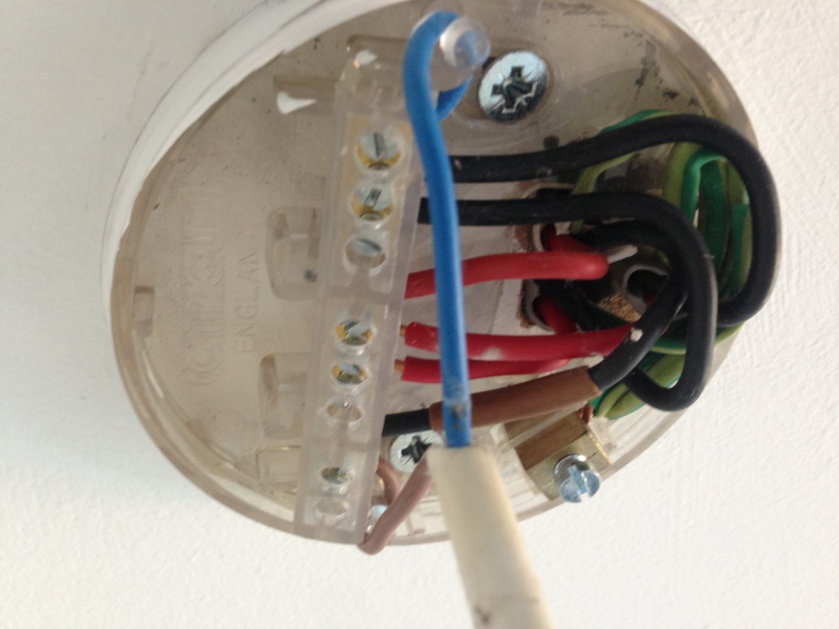

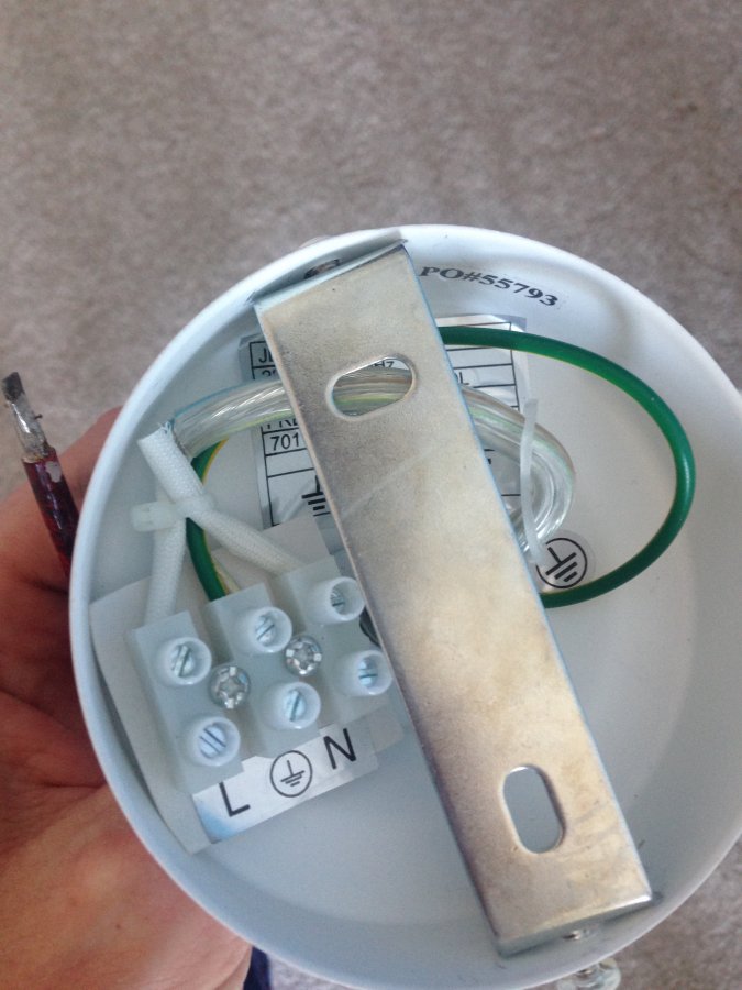

Hi
I've got a similar issue. I've changed a fair few ceiling roses but I've just bought a light with only 3 connections and I have a loop circuit. The live, neutral and earth wires are self explanatory but Any advice on what I do with the loop wires? Can I just buy a chic block 3 wire connection and install that in the new rose?

And as the answer in the Wiki, as per
Please stop hijacking posts and please stop multiply posting the same question.
I don't know if you can.
People usually put up with unstylish ones like this
I've never felt the need to look for a chic one, so IHNI if they exist.

Thanks EFL - came up with an error on previous thread so didn't think it had posted. Thanks for advice though
Just to check - do all 3 wires go in the same block - I assume so given they're not connected otherwise? Thanks in advance
