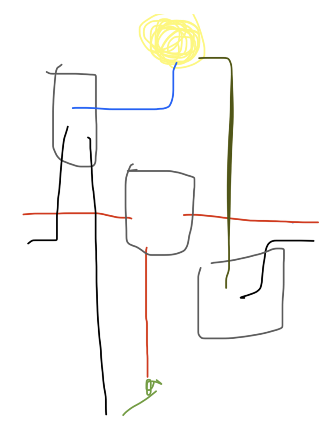

People make mistake changing lights all the time usually because they pop the ceiling rose off and are faced with 3 reds/browns and 3 blacks/blues (unless it's the last one on the circuit). They also have a brown/blue from the modern light so all the colors get put together by colour. This puts the light permanently in circuit and allows the switch to short live to neutral popping the breaker. Always take a picture when you change electric fittings. If you're faced with multiple wires that look the same use a sharpie to put 1, 2, 3 etc dots on the grey sheath before you take a picture

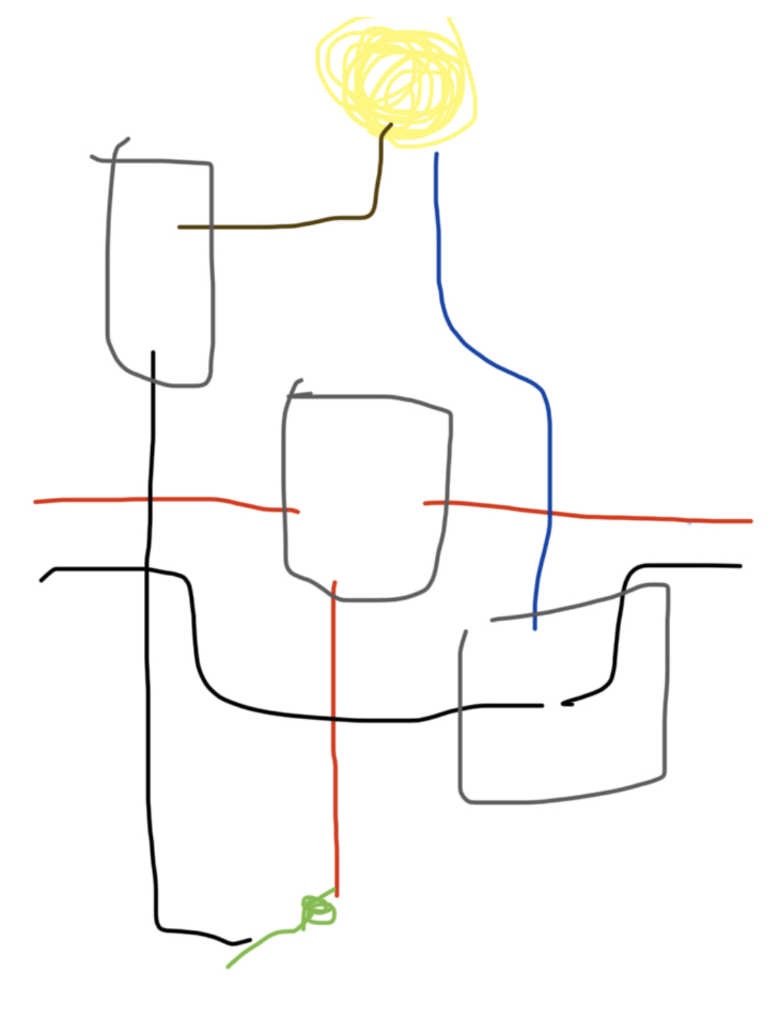

The usual mistake:
Wire from the last light comes in on the left, wire to the next light goes out on the right. Putting all the lives into one and all the neutrals into another causes a problem.
From your description you seem to appreciate the switching but if you wire this:
There will be enough of a live coming back from other downstream lights switched on to illuminate the local bulb, particularly an led. Flipping the switch shorts the live and neutral and pops the breaker.

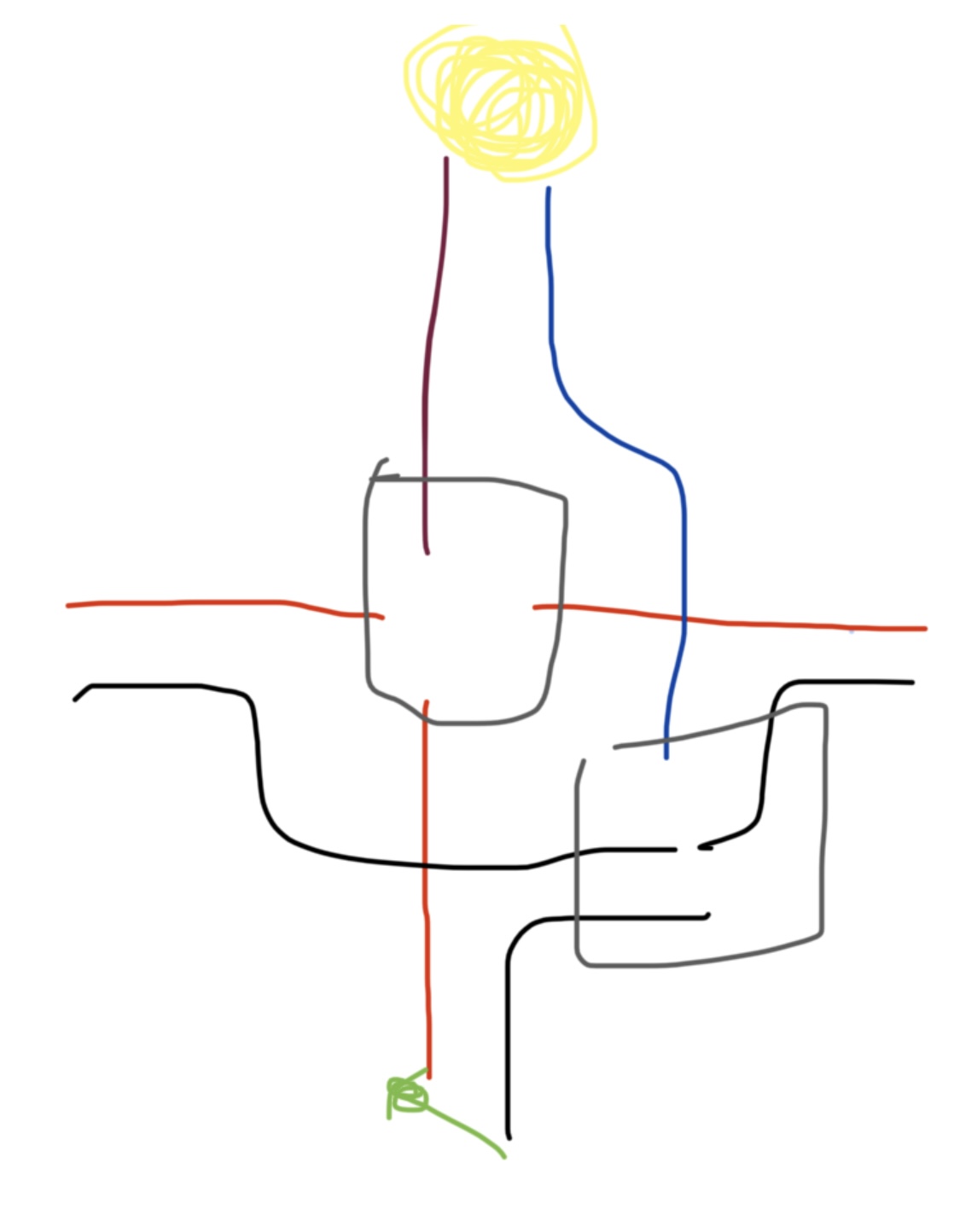

One of the ways to wire it working is like this:
*(ps; I've talked about it like it's DC because it's easier to understand)
