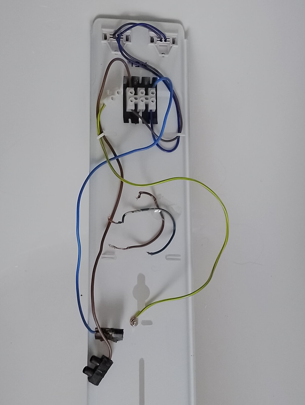

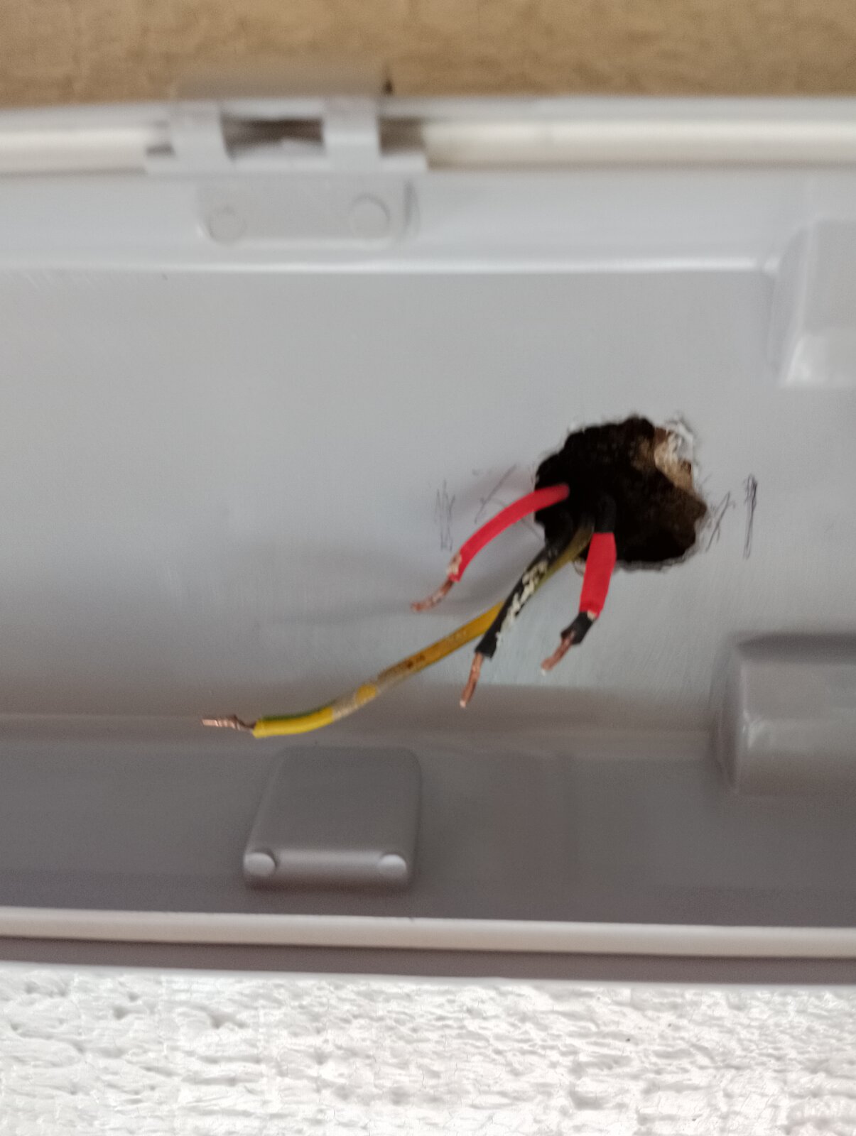

Are there any wires hidden up inside the ceiling? With only one red, two blacks and one earth I can‘t see how the bathroom light would be affected.
The most logical explanation (but by no means the only one) would be that red is the switched live, the blacks are neutrals and two permanent lives are linked out of side.
You need some kind of measuring device (multimeter or two-pole voltage tester) so you can measure which is which.
Measure between red and earth with the switch in both positions. If you only get 230 V (or thereabouts) with the switch in one position, red is the switched live. Then measure from red to both blacks, one after another, while the switch is one. The black that gives you 230 is the incoming neutral. If that‘s what you get, connect both blacks to the blue on the light and red to brown. Earth to earth.
If not, you might need to get an electrician involved.

I'm only on quick, I'm back tomorrow. Here is a few things that may narrow things for you.
Kitchen ceiling wires -Two black together into neutral, red into live, y/g into earth - The lamps only wall switch operating on & off as normal, the bathroom lamp not working, the bathroom lamp wall switch now operating kitchen lamp as does kitchen switch.
With the multimeter black probe on the earth, the red and one black showing power (I've marked it with red tape).
No other wires in ceiling.
The 2 small wires taped for purpose of photo and I've no idea what part they played.
I've sent photos of how it looks now and I'll be back there tomorrow.

A huge thank you to Ragnar_AT.
Your instructions were clear, easily understood for someone not in the lighting business and a very accurate diagnosis of the problem.
I followed your instructions and it's all working perfectly.
Bathroom is shiny and bright and back to normal too.
I've figured out the two small pieces of wires must have been just to lengthen and enable to reach the old lamp connection fittings. I've done the same thing with longer, new pieces of correct colour coded wires to make it easier for me to get access for my hands/tools. This new lamp is (5ft) compared to old lamp (3ft).
