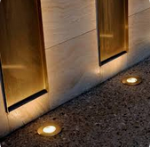

I know my parent's house had wall lights, but floor lights, not sure how they would work? I have a high socket on my landing with a rechargeable torch, which has motion sensor, and auto lights with power cut, but can't see how floor lights would work, seen them in a dance hall in Chester in the late 60s early 70s, but they were as well not instead, and personally I like carpet on the floor, OK google shows
so above carpet, would have thought a trip hazard? See the point on a patio where there is nothing to mount wall or ceiling lights onto, but that is a lot of wiring.
It can be done, and would be a talking point, and would ensure floors kept clear, no laundry baskets on that floor. As an addition to ceiling lights, OK, but to me just too easy to cover.
I know my parent's house had wall lights, but floor lights, not sure how they would work? I have a high socket on my landing with a rechargeable torch, which has motion sensor, and auto lights with power cut, but can't see how floor lights would work, seen them in a dance hall in Chester in the late 60s early 70s, but they were as well not instead, and personally I like carpet on the floor, OK google shows View attachment 362831 so above carpet, would have thought a trip hazard? See the point on a patio where there is nothing to mount wall or ceiling lights onto, but that is a lot of wiring.
And difficult to walk around without being blinded while looking where your'e walking.
We had a hotel room with such uplighters in a plinth about 40mm above carpet level, quite honestly they were aweful as a fairly wide beam angle. The horrible downlighters creating vast shadows compounded by not being able to look down do simple things like put shoes on or pick up a bag.
