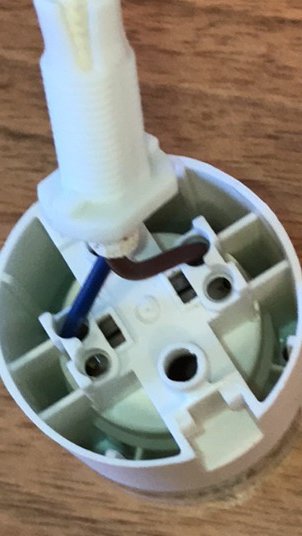

Could it be a thermal fuse in there?
I suppose I could leave the top and connect it as it is. The flex would be much to long then though. I'd have to shorten it from the other end. I unscrewed the bulb holder, but can't see how to remove the wires. Any idea?
Lamp holder is the same as mine. You need a small flathead screwdriver to press into those rectangular slots next to the cables.
If you’re disconnecting from that end you may as well do away with the rest entirely and connect that end to a new 6” ceiling rose - that’s what I did and it’s much neater
