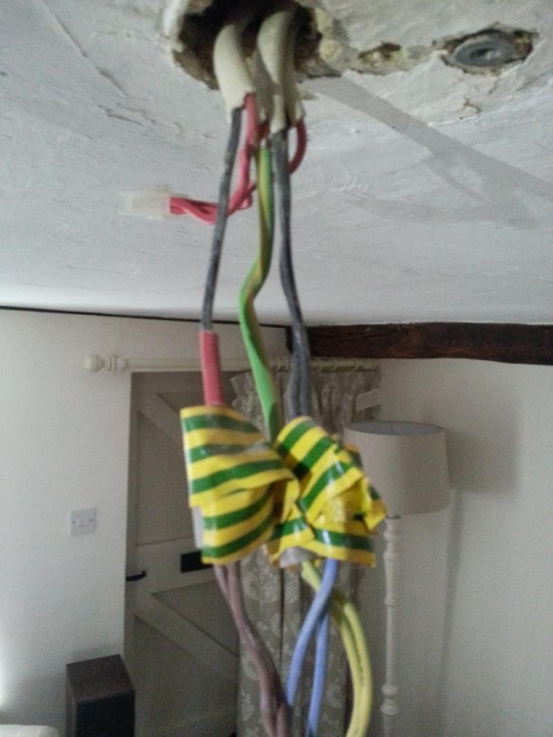

Ceiling Rose - single wire in loop block?
Thanks! I had tried to get behind that rose before and given up. With a lot more wiggling, here we have it:
So I think the 2 browns and 2 blues from the rose are both just connected up together - and that lone blue wire in the center block was just being kept out of the way.
I think I am therefore already at step #3 on
//www.diynot.com/wiki/Electrics:Lighting-Rose
and should lose the fantastically well wrapped connector blocks, put the switch live (black with red) into the new light's L, put the two blacks together into the new light's N, + all the earths?
You got it. Wire it as you describe.
As you can see, the blue that was on it's own was in fact connected to neutral, but not at the rose.

Just goes to show that when you look at a seemingly neat and tidy install, as in the first picture, there is no way of knowing what horrific bodge might be behind (or, literally, above in this case) it.
(the flex was an obvious clue, though!)
