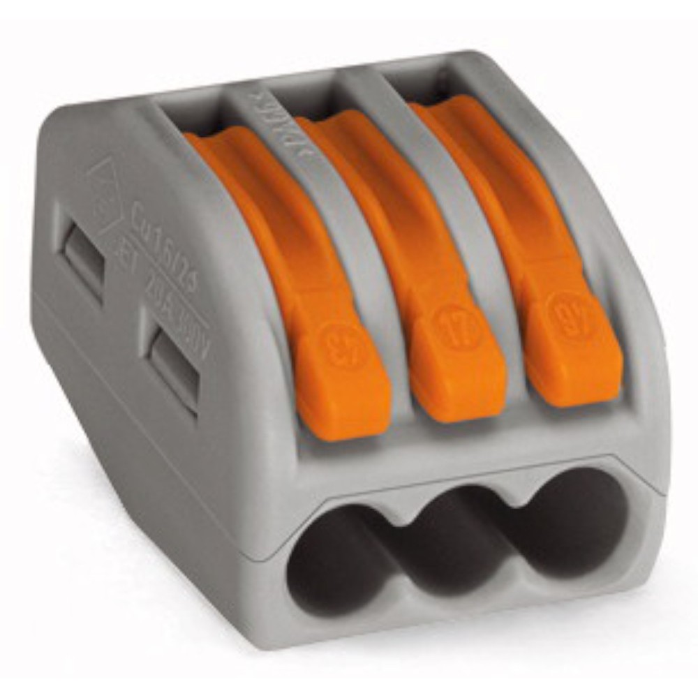

Ah OK fair enough, in that case use 3 way wagos on the live loop (red middle) and neutral (black/blue) and 2 way on the switched live (red/brown) and 4 way on the earth, make sure you earth the body of the light if it needs it. Make sure the ones you user are suitable for 1.5mm solid cable and also whatever cable your light fitting has, probably thinner stranded.
Your new light is likely to have flexible cable, so unless your set of wagos includes some of the Lever ones then you will struggle.

The New LED light does not need earth. Therefore I will put 3x earth wires into a 222-413 connector.
The Middle loop (3x red loop cables) again go into a 222-413 connector

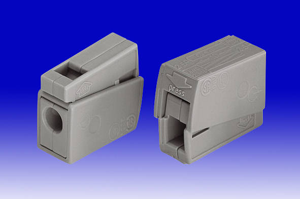

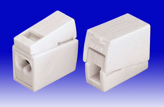

2x Neutral go into 224-112 and one comes out which goes to the LED Ceiling Light.
1x Red Live goes into 224-101 connector and 1x comes out of the other end which goes into the LED Ceiling light.

Is there any reason that the 224-112 can't have a solid cable in the "stranded" entry ? It's still going to have the same spring loaded connection - the only different is normally the ability to manually lift the terminal as stranded cable isn't strong enough to push into the other types.
If there's no objection, the whole thing scan be done with 4 of them - which (unless the OP already has a selection box) means buying just one type of connector instead of 3 or 4. So loop in and loop out go into the solid ports of three blocks (L, N, & E). L & E to the switch goes into the stranded ports of the L & E connectors. Switched live from the switch goes into one solid port of the forth terminal - and the pendent 2 core cable then goes into the stranded port of the N and switched L terminals.
