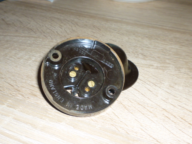

Hello,
I recently purchased some antique ceiling roses (bakelite material). Inside there's only 2 terminals, so where do I connect the earth cable to?

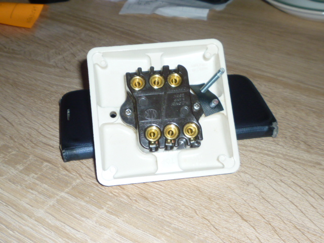

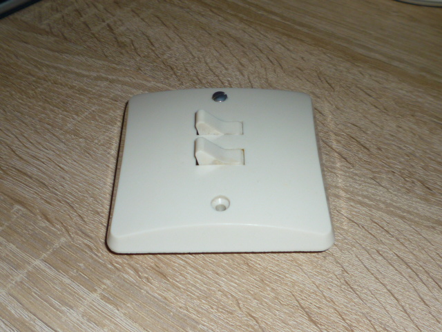

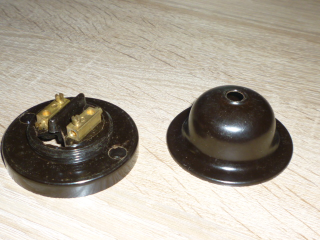

I recently purchased an old house (circa 1880) and it's currently undergoing a major refurbishment. I would like to use bakelite electrical accessories as I think modern plastic won't look right in an old house.
Here are some pictures. Are these safe? If not, can they be modified by swapping internals from later electrical accessories?

I think in later years they strarted to fit ceiling roses on round patresses that included an earth terminal, but I suppose a small connecter block could be used within the housing.
I only ever see patresses in white though similar to these.
I think Mk still sell white ones for use with old style Batten Holders
Your ceiling roses are definitely old, probably just post war. Pre war they would have been made of porcelain. The switch is relatively modern, late 60's. It will probably be supplied with 4BA screws which you will need to replace with M3.5 to fit a modern flush box.
That's a brilliant idea. Does the earth terminal in the pattress (or a small connector block) have to be connected to anything?
What brand is that pattress? I tried to search on Google but could not find it.
And what about for the wall switch? I suppose a flush box with earth terminal?
An earthed point should be there regardless if needed
The patress i posted is Hager
http://www.hager.co.uk/product-cata...essories/mb326e-mt/46071.htm?utm_source=print
Them light switches are standard mk size so will fit anything that a new switch of almost any brand will fit.
The earth terminal was mainly to park the earth as it was normally not needed as it was all plastic, however if a metal fitting was too hang on the rose then the earth would join in the terminal and carry the earth through to the fitting.
Same as with a metal switch
