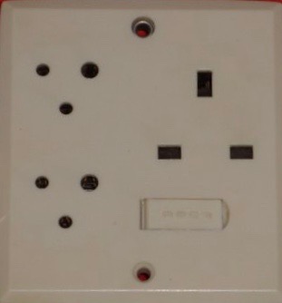

Talking of old fittings I came across 2 of these recently in a 1950's bungalow one in each of 2 bedrooms. I believe they were original fittings.They were mounted as shown but I believe by looking at the writing on the fuse carrier they should have been rotated 90 degrees anticlockwise. The fuse feeds the two 2 amp sockets and is the smaller BS646 type. A 5 amp fuse was fitted.
I now have one of them for the cost of a free of charge upgrade to a modern double socket. I was not allowed the second one as that room had just been newly decorated whereas the first room was due to be decorated. The name on the back is MEM.

I have encountered these too.
The faceplate shown in your picture, as I recall, doesn't fit a standard back box, and came with an open-backed pattress which fits over a standard single flushed-in box.
A sort of Converta socket of it's time.
The job I removed these from was a some sort of 1960s DIY project, where a stranded twin and earth cable had been laid into a V-shaped groove literally cut into the floorboards presumably by a machine.
An inch hole had been made through a floorboard to acomodate three plastic connector blocks, as the cable then split into a Y formation to supply the two sockets.
I think around the 1960s it was quite rare then to do DIY electrics, unlike now.
This had a backbox standard size in one direction but about 1/2 wider in the direction of the fixing lugs. Getting it out caused the decoration problems as it was mortered in.
