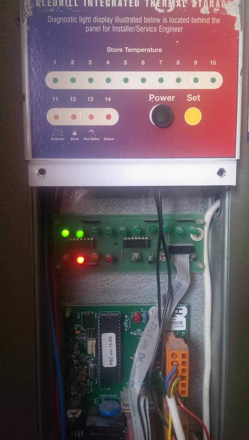

I've managed to check the programmer and roomstat are working properly so I moved on to checking the supply to the motor on the 3 port valve.
When the CH is on, irrespective of whether I want it on or not there is 240v between the neutral and the DHW, CH and boiler feed when checked at the circiut board.
I'm only a novice DIYer so I thought when the CH was properly off (ie no roomstat or programmer on, rads all cool) there would be just 240v to the DHW and boiler feed but found there was 390v (yes 390v) between neutral, DHW, CH and boiler feed. I rechecked this and tested my vault meter on another circuit to make sure it was working properly. To my mind this can't be right and would welcome any thoughts on this.
The diagnostic board at the top of the picture goes out when the CH comes which I haven't known it to do before, I haven't put my test meter on it so I don't what's going on there.
In the centre of this picture you can see the lower right portion of the pcb where I tested the outputs to the 3 port valve.

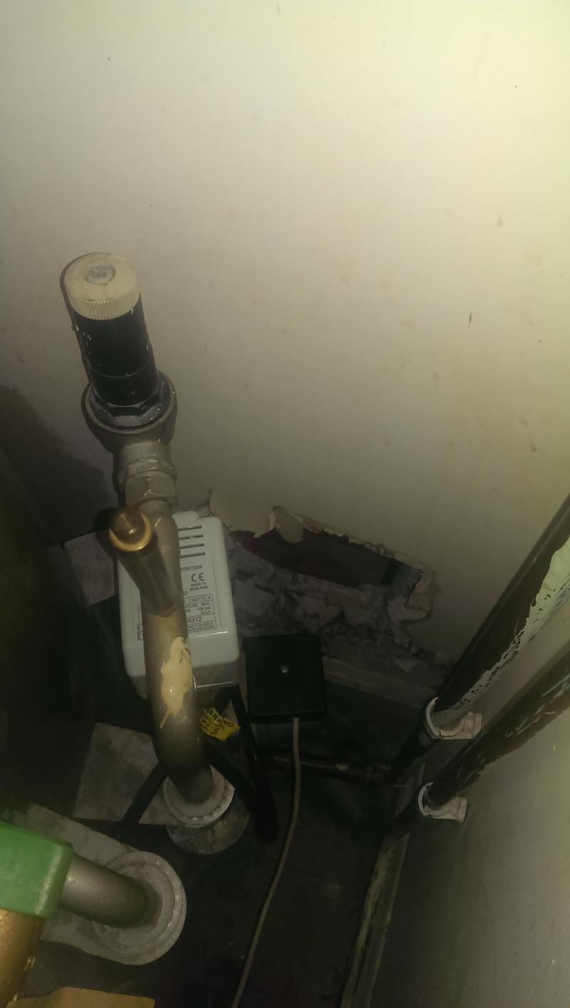

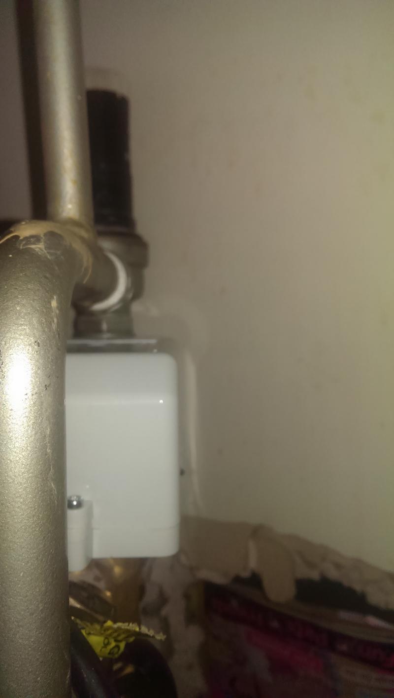

My next port of call was the valve and header but I couldn't get the cover off due to the pipe above it.

It could be the 3 port sticking, unlike a conventional system the 3 port does not do dhw, the 3 port can do heating and/or replenish the store, if it is sticking the central heating will come on every time the store is brought back up to temp you could try changing the 3 port head but thermal stores are notorius for sludge and could have damaged the valve body.
I'm trying to nurse it through one more winter, I'm not flush with money currently. There can't be many left, truly awful as you say. I'm suspecting the control board at the moment until I can rule out the 3 port and motor. The fact that I can't clear the pipe above the motor casing makes me wonder if I need to drain the system and remove the pipe to access said case? The motor must have been replaced with a taller model last year as I remember having a look at the motor before. Worst case scenario is about £500 for boards and valves if I d.i.m., admittedly expensive for a sludged old system, any ball park figures for a suitable replacement? BG quoted £6k for a combi which I'm not keen on!
Thanks again for the replies.
About an inch, had a go at it yesterday,might clear with force,the cover is fairly flexible and judging from the calcium on the pipes it looks like that might have been persuaded like that before
I have now noticed CH coming on every time the store is calling for heat, thanks for the direction picasso. Today I finally figured out how to take the head off, the valve spindle is fine as is the motor and the cam lobes are working the switches ok. When I switch the store off the valve is returning to its HW position ok so I have moved back to the SAC board. If I disconnect the white feed the motor won't go over to CH only or mid position which is what I'd expect with my limited knowledge. If I disconnect the programmer and roomstat from the board I'm still getting a feed at white wire. Would you suspect the SAC board?
Ok, so today swspped the mid position Valve and head and same symptoms persist however the old one looked and felt on its last legs so not entirely awasted couple of hours.I'm now back to thinking the cause of the CH staying on its the main circuit board.these are going for about £160 and the diagnosticboard might need replacing to.I've come across central heating control packs at screw fix,I'm wondering if these would circumvent the control boards.Amy thoughts please, aside from complete system replacement which is probably acouple of years away.Thanks again.
Thanks again for the replies,it was indeed the main pcb board, paid about £140 for it.
