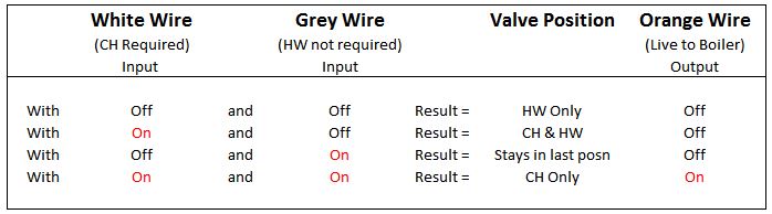

if you have a multimeter (and know how to use it), check the voltage on the orange wire when CH is On (240Vac) and Off (50-150Vac). If the Off voltage is higher than 150Vac the problem could be the valve. If below 150Vac, the boiler is probably the problem.
Once the valve has moved to the heating only position, the orange and white wires are connected by a switch inside the motorised valve. I suspected that some voltage from the boiler is fed back via the orange wire and through the switch was sufficient to keep the valve open. BUT, the bit I can't get my head around, is that if that was the case, the white wire which is now connected to it would also be at 115V and it isn't. So, I'm tending to think that it may be the valve.
Personally, my next step would be to 'bench test' the motorised valve actuator. If you are competent and can do it safely, it's not too difficult. I have a little test rig with a switch for each of the inputs (White and Grey wires) and connect my multimeter to the orange wire to show when it's 'on'. By switching the white and grey wires on and off, it's easy to check that the valve position and the output from the orange wire are as they should be according to the table below:

Perhaps a simpler test I would try, is to disconnect the orange wire and operate the system now. The boiler shouldn't actually fire up the central heating with the orange wire disconnected (it should still work with the hot water though) If the fault is still present (ie, the valve still sticks in the heating position with the programmer off) you can rule out the boiler causing the fault, because it isn't connected to the boiler anymore.
I have made a two switch test rig which I have left connected for now.
I ran the test through several times. It was carried out with central heating only at programmer and room stat on high.
Results differ from your table
white off grey off valve is in W position 0v on orange wire
white on grey off valve is in mid position 8.9v on orange wire
white off grey on valve is in W position (has moved) 0v on orange wire
White on grey on valve is in H position slight voltage 0.1v on orange wire
A 'bench test' means that the valve is being tested on a bench. ie out of the system and so not connected to the programmer and room stat anymore.
EDIT: Regarding the tests.
That's OK as per first line of the table.
Also OK as per second line of the table
This could be OK. The valve "stays in last position" with his test, so if there has been a slight delay in moving from test 2 to 3 that has allowed the spring to move it back towards the W position that's OK.
That's right in that the valve is in the H position, But, the orange should read 230V

I have edited my earlier post to show comments about the test results. The only really wrong one is the last one, but I can't figure out how that would cause the problem you describe.

Interesting! That's the wrong result. With the orange wire disconnected and only the heating 'on' the valve should move to H as it has, but the boiler should not be firing (because it's the orange wire that does that) This will need investigation to find out where the boiler is still being energised from.

Based on the first result above I am leaning towards a wiring fault. In the bench test the actuator seemed to perform OK, except for the lack of 230V on the orange in the H position. Maybe there is more than one fault.

Now I have corrected my stupid mistake the orange wire disconnected test indicates everything OK with the boiler.
But the table you provided test with white wire on and grey wire on showed 3 port valve position H which is correct but near zero voltage on orange wire which is incorrect as it should be 230v.
So if my logic is correct then the absence of this 240v is significant as it is the only thing that seems out of place

That's a good question. The absence of the 230V on the orange wire when the valve is in H position (white and grey live) should mean that the boiler wouldn't come on when the valve was in the H position, when in reality the opposite is true....which is really baffling... Anyway, if the 230V is missing, under these circumstances, the valve is certainly not working correctly.
Then I suspect, that possibly they haven't been wired in correctly. Why were they changed? Was there a fault before, and if so what was it? You are quite right when you say:
When unpowered, the motorised valve is held by a spring to close the central heating outlet.
When central heating is required, the motorised valve receives power (on its white wire) from the room thermostat via the programmer to operate the motorised valve motor and open the heating outlet.
If the thermostat, or programmer go 'off', the live should be lost and the spring pulls the valve back to close off the heating port.
It's possible, if it's been wired in wrongly that there is still a live on the white wire when there shouldn't be. Someone with electrical knowledge and a multimeter would be able to physically check this.
