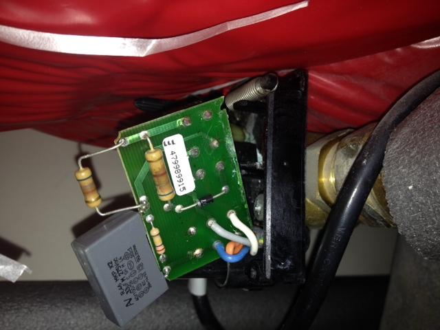

Sorry to drag up an old post. I'm having similar issue to this.
CH not switching on, but HW is. Mixing valve is energising, with HW program ON holding mixing valve to CH position radiators get hot. Bled radiators but no air trapped.
Also checked voltage at junction box but getting no readings (more than 2-5v) but think that might be my meter as the mixing valve and pump are working.
Only other comments is a couple of times when when CH was working it tripped out the house circuit breaker. Both times happened when CH was ON and the programmer turned on the HW.
So have I blown a fuse? or faulty micro switch in the mixing valve motor?
Can I link the orange wire to the white or grey wire to bypass the micro switch to see if the boiler starts up?

Might of figured out the reason. Took the micro switches out and looks like the track from the bottom relay to the orange wire has rubbed off over the years.
Now to figure a fix.

Measuring the voltage on the back of the second micro switch I get 60v middle pin (directly linked to orange). Both other pins I get various voltages so guess meter isn't detecting a voltage. I get this in both open and closed positions.
Does that sound like faulty micro switch? or a break elsewhere on PCB?
Ian.
Traced through the voltage.
Goes through the first micro switch okay, goes through a resistor then to a diode and this is where the 240v stops so looks like a faulty diode. Could explain why it tripped the house electrics if the diode was breaking down maybe.
Problem is I cant tell what number is on the diode, anyone know the part number for the diode?
They dont sell parts for these pcb's on their own. So its a new actuator head, or maybe a trip to maplins if you really just want to repair the pcb.
I think I've sorted it. Turns out a track on the other side of the PCB had also wore off meaning no voltage to the second relay.
So repaired that track as well as the first one and appears to be working now. Just need to see if it carries on working with the switching between HW/CH and both.
