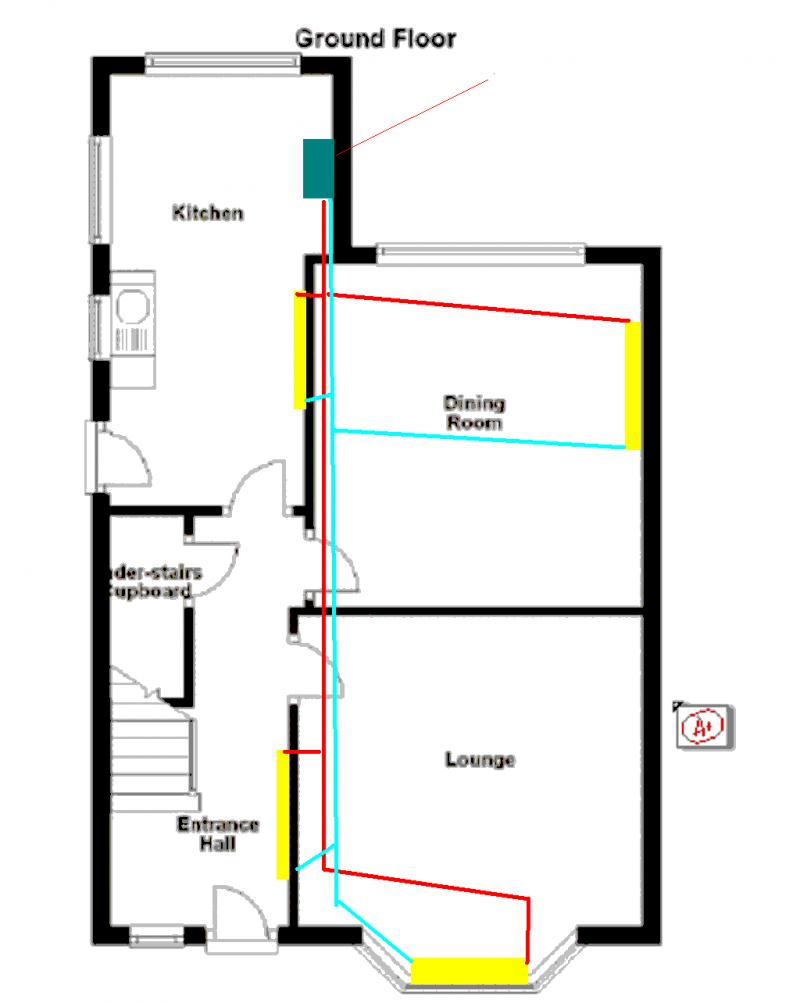

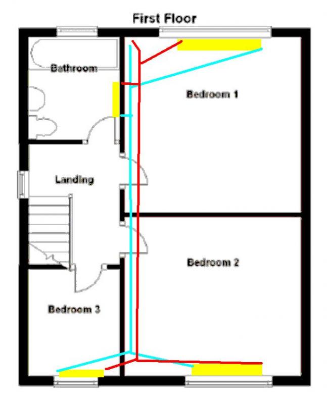

@ snowlan, sorry to hijack your thread, the layout on your plans looks ok.
