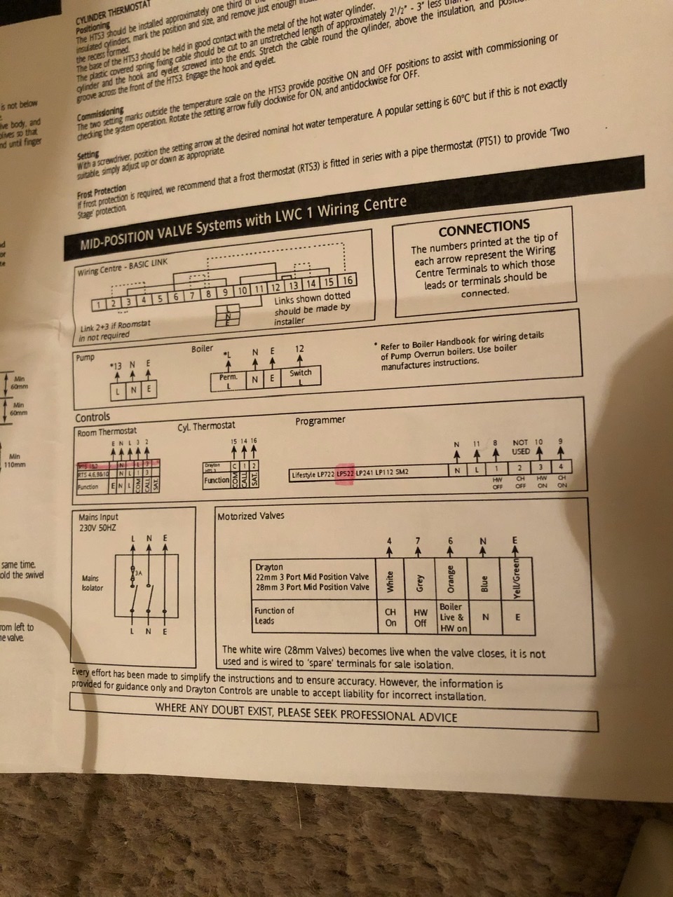

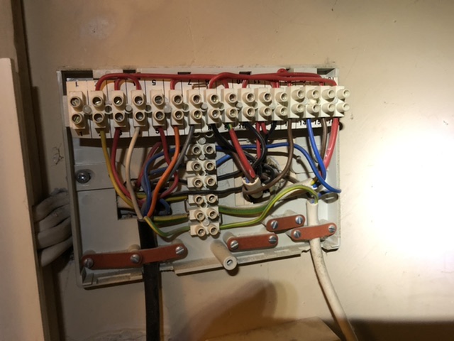

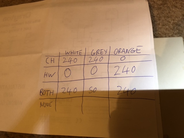

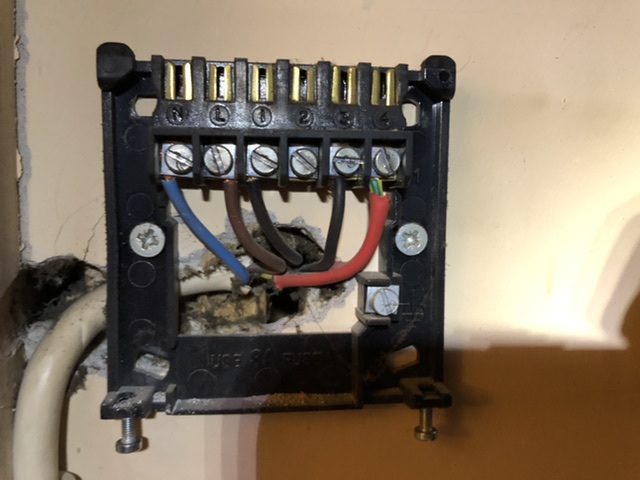

08F8949C-56CD-41D2-8372-7A91CC5C3331.jpeg 56E13687-4C3E-4060-A085-DF6F8C867F32.jpeg BE0E67FD-054C-43A3-9180-D1F6FE49BF3A.jpeg 623B41CF-78E1-48B9-9EDE-EC705B0F0D86.jpeg

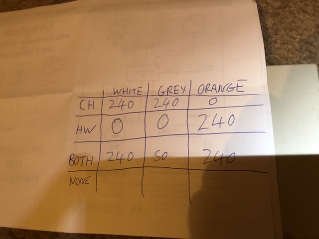

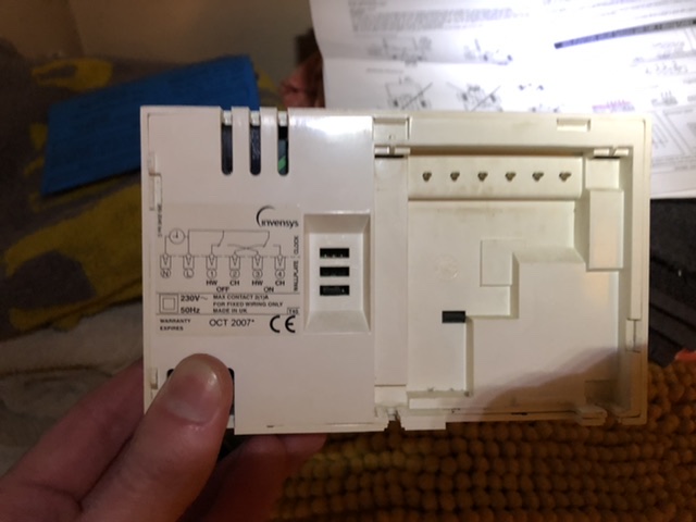

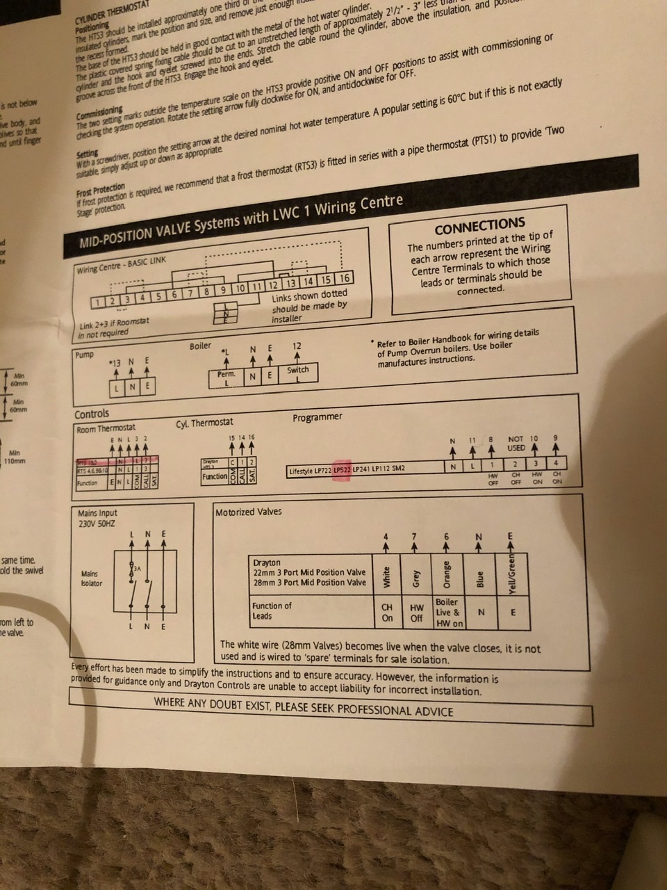

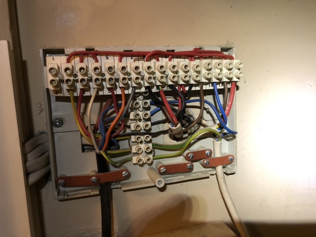

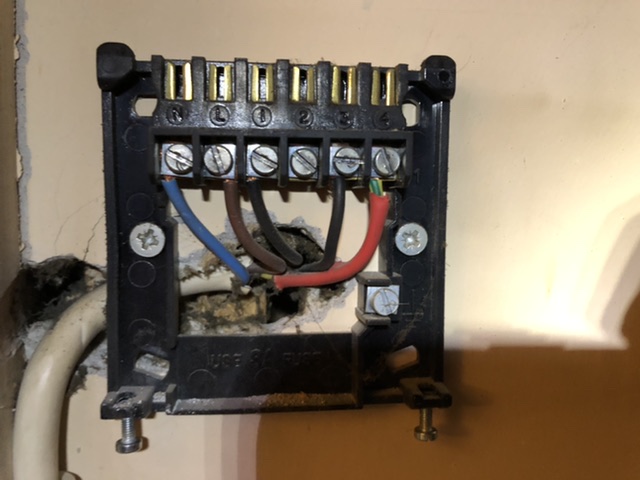

Ive attached images of the programmer wiring, junction box and results of testing the actuator voltages.

Just tried this and having both CH and HW on the programmer, turned the cylinder stat right down and the boiler turned off.
Also checked the output with only CH on from the Programmer In the junction box and got 240volts
post a pic of the wiring of your programmer, when the programmer is set to CH only the valve should motor to H, and then the microswitch will power the boiler, but you need a HW off signal for this to happen, so either your programmer is not switching the HW off terminal or more likely it has never been wired in and that is why the valve was latched in the first place
With only CH turned on the HW off terminal (pin 8 on junction box) is showing 240vC8918CC1-BCD8-4280-B4A7-9AE0AA4A0E37.jpeg
sorry for the multiple replies, just trying to cover everyone’s very helpful suggestions!
Because the HW off is not wired correctly

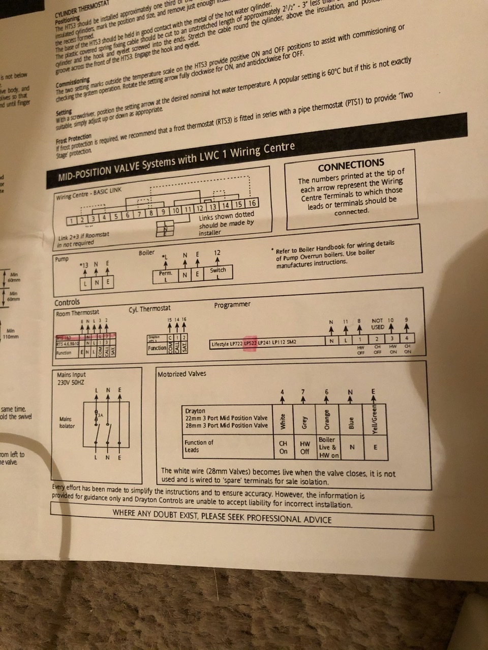

Pin 1 (HW off)from the programmer goes to number 8 on the junction box and the grey wire (HW off) from the valve goes to number 7. These are as per the attached wiring diagram.
Or am I still missing something?
Thanks for the pictures, however, if it used to work OK and you haven't changed the wiring, I wouldn't expect anything to be amiss. I'm, still a bit confused by a couple of your posts, but it will probably be me not grasping the sentiment.
