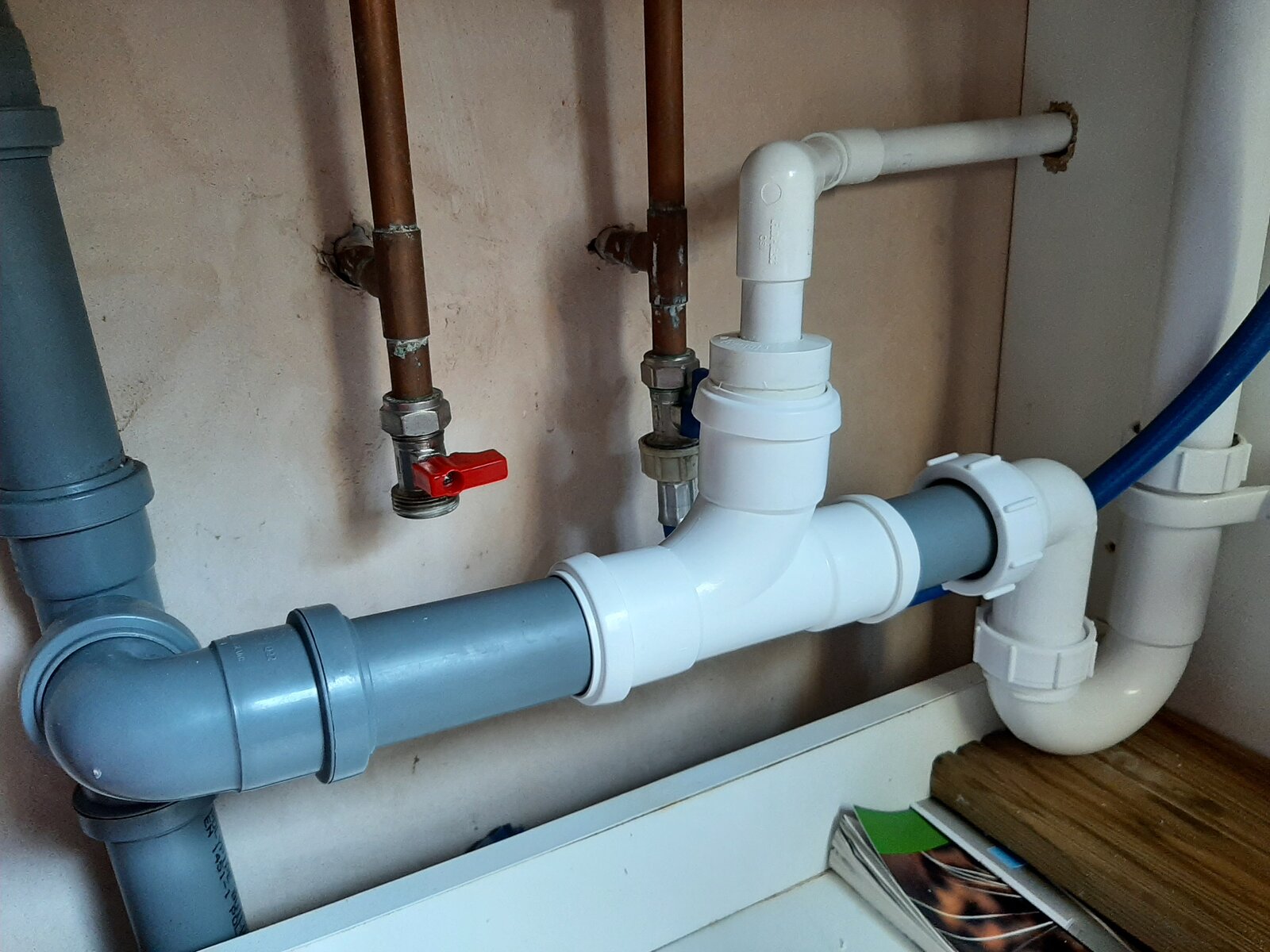

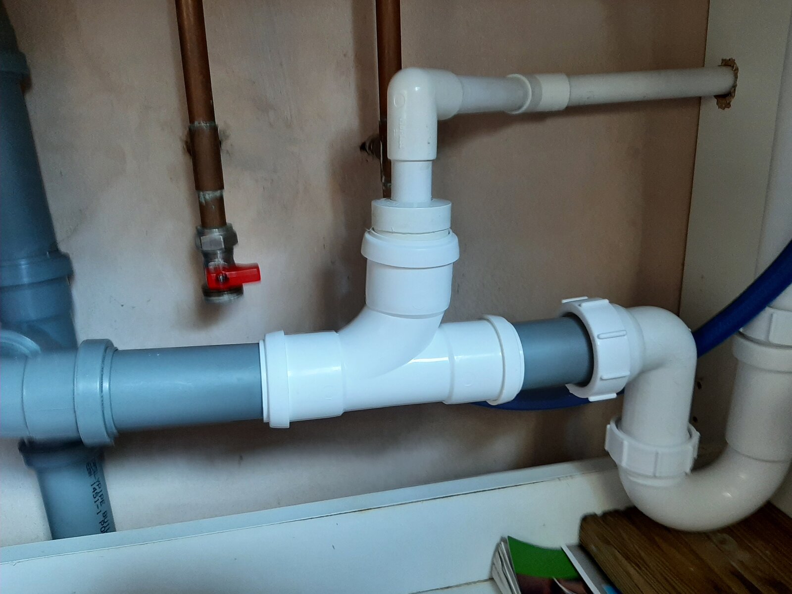

Thanks. I will video the blue light. I have to say that the condensate trap is not situated very well and linked to the waste pipe under a sink unit. I did wonder after the trap was fitted a couple of years ago whether the angle of the waste pipe, very little angle, could have any effect on the running of the boiler. Although there was no issue for some time.
If you can remove the connection under the sink see if it is gunged up with soap or stuff

Thanks. I've attached images of the condensate set up which doesn't look ideal to me.
The condensate trap is under the boiler, this is the waste where it connects, which could also be blocked.
