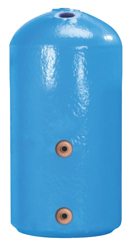

If the OP says
I turn on the immersion for the hot water
and means the electric immersion heater, there is no good reason why the boiler should start, nor the heating.
But if he means he turns on the HW control on the boiler, it would be quite possible.
Some people say "immersion" when they mean the hot-water cylinder.
But a trained eye can tell them apart.
Hot-water cylinder
47140_P
immersion heater
75262_P
