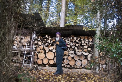

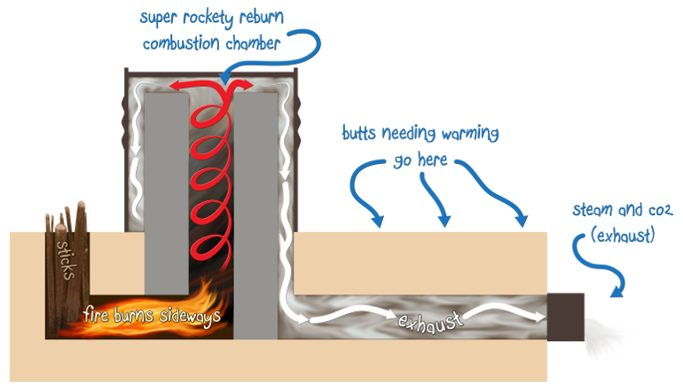

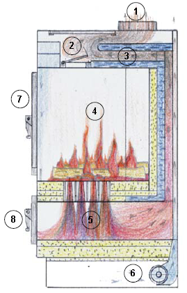

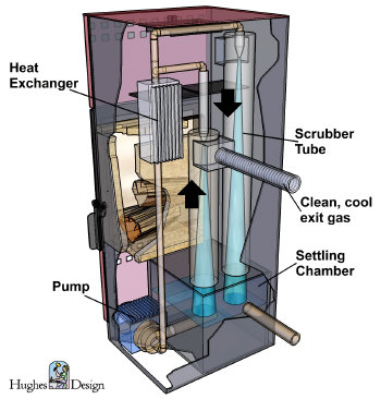

So in real terms the house is built around the heating, near impossible to install as an after thought. I had a friend who used wood burners and he needed to store the wood for three years before use, so Wood_store.jpg this was around 1/3 of his wood store, yes there are some really clever wood burners, this wallnoefer.PNG looks really good, until you realise it uses an electric pump, so you need back up pumps, generators etc to run it safely. This rocket-mass-heater-diagram.png seems a great wood burner, try getting house insurance once installed. And this Hughes Condensing Stove 2 small.jpg seemed the bees knees condensating wood burner, but again problem arises if you lose power. This Torrent pipe example.PNG looks great until you price it all up, and unless like my friend you have 20 acres of wood land getting the wood is not easy, around 2000 you could get old pallets and loads of other old wood, today there are just too many people trying to find cheap wood, the heritage railway I work at needs wood just to light the fires, and they struggle getting enough. And coal goes off, once coal is out of the ground it starts to degrade, so once the last Welsh steam coal mine closes then heritage railways will have a problem getting good coal. Yes with a larger fire box they could work, but that would mean a completely redesigned engine, the same applies to wood burners at home.
