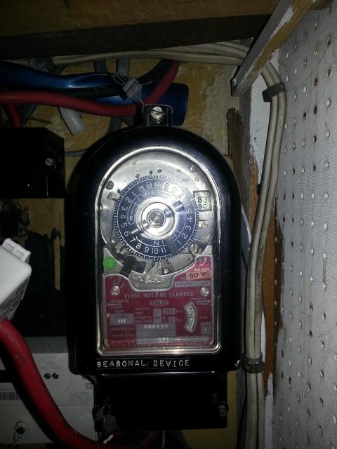

Is the Venner device still made? It's looks old and can't find current stockists or models on Google.

The Venner device was fitted in the 1980's and could of been second hand then.

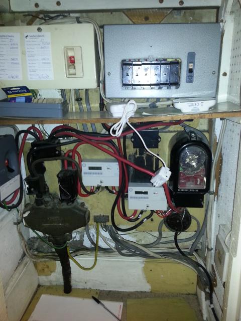

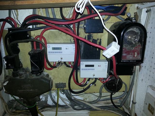

Thanks. Sorry for the delay in replying. Took a while to get the pictures. Here's the cabinet with the old fuse boxes. Each fuse box is connected to a meter via blocks (there is a 3rd box with a single fuse on the left too).
There's a picture of the Horstmann device too.
I noticed there's only a single 100A fuse on the intake for both meters, even though the storage heaters can draw that on their own.
Is that a problem? The meters were swapped out in 2009, but the fuse was not changed.
Updating this is getting complex. The cabinet would need to be rebuilt to fit bigger fuse boxes. And the timing still needs a solution. So I guess it might wait for next year after we see how it all performs - might just add a timer or two on individual heaters.
