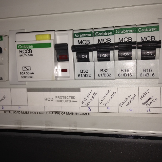

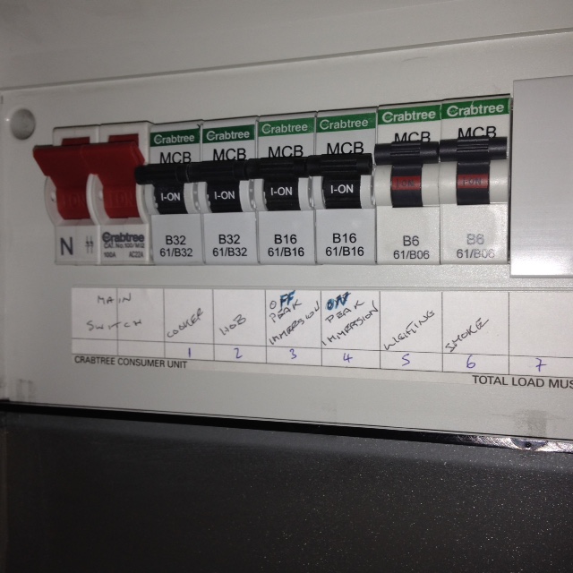

If wonder if those two switches marked "off peak" and "on peak" are not some crude way of enabling the heating to be switched from the E7 only circuit to a normal 24H circuit so that they can be used during peak times if needed?
Could we have a shot of the consumer units, etc?
------Ive attached the shots

If wonder if those two switches marked "off peak" and "on peak" are not some crude way of enabling the heating to be switched from the E7 only circuit to a normal 24H circuit so that they can be used during peak times if needed? Could we have a shot of the consumer units, etc?
There is no evidence of a separate 'E7 circuit' - I presume that, as with my E7 installation, everything switches over to cheap rate during the night hours.
I can but assume that the "Off Peak" and "On peak" immersions refered to immersion elements at the bottom and top of the cylinder respectively - so that if one 'had to' turn on an immersion during peak times (for a daytime 'boost'), one would use the one that only heated a bit of water, and therefore used less 'expensive electricity'!
