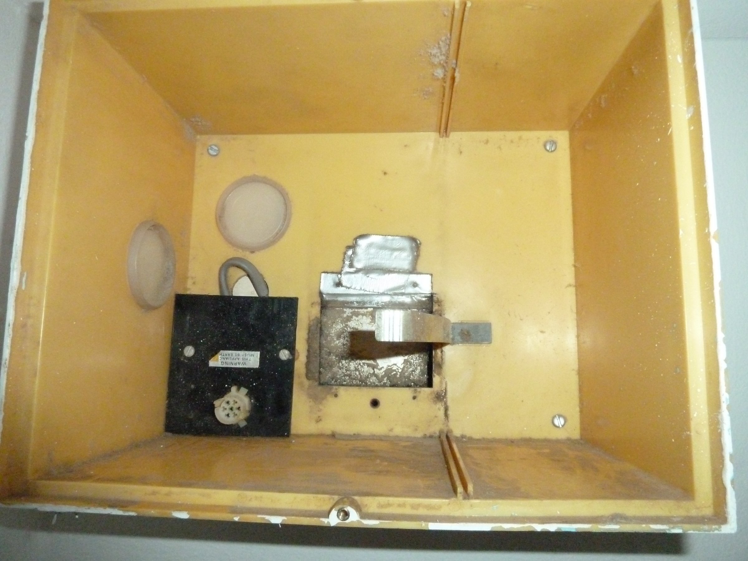

The duct is not accessible. But it is a void that runs vertically through all the flats. So this has to mount on the wall of the duct, and just vent into it.Hence it needs a centrifugal wall mount. An inline or an axial is no good do to the longish duct run.
I may have to look for some quieter options then. I just want to avoid cheap crap that will only last a few years.

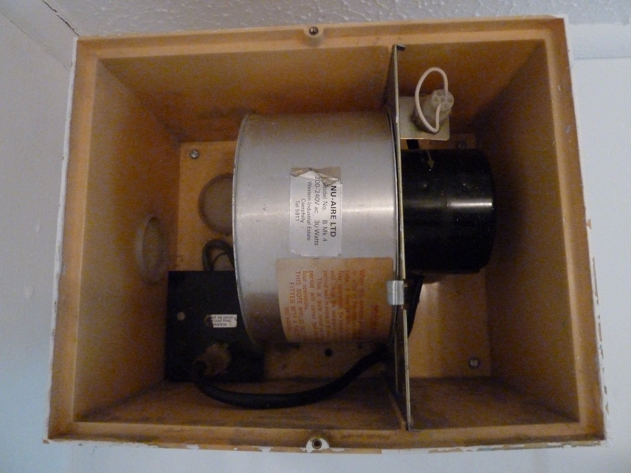

This probably explains it better than I am. The riser vent is on the other side of the wall it is attached to.
full
So with the fan removed....
full
As you can see, there is just a cut out in the wall panel and it vents into the shared "riser vent".
That flap is the back flow flap.
I assume any modern wall mounted extractor will probably need a new cut-out and slot into it.....something like that I guess?
Looks surprisingly clean
I reckon you could fit something quite big
What are the dimensions of the hole in the wall?
It might benefit from a fire-stopping shutter.
Ahh, this photo is from a few years ago. But, I did check it about a year ago and it was still pretty clean actually.

It's been suggested that the existing fan, although clean, may not be up to the job any more and the motor (although not showing any signs of breaking/bad noises etc) will not be doing as good a job as it was from new).
Motors generally either work properly or not at all.
Is there actually anything wrong with the existing fan? Does it even need replacing?
