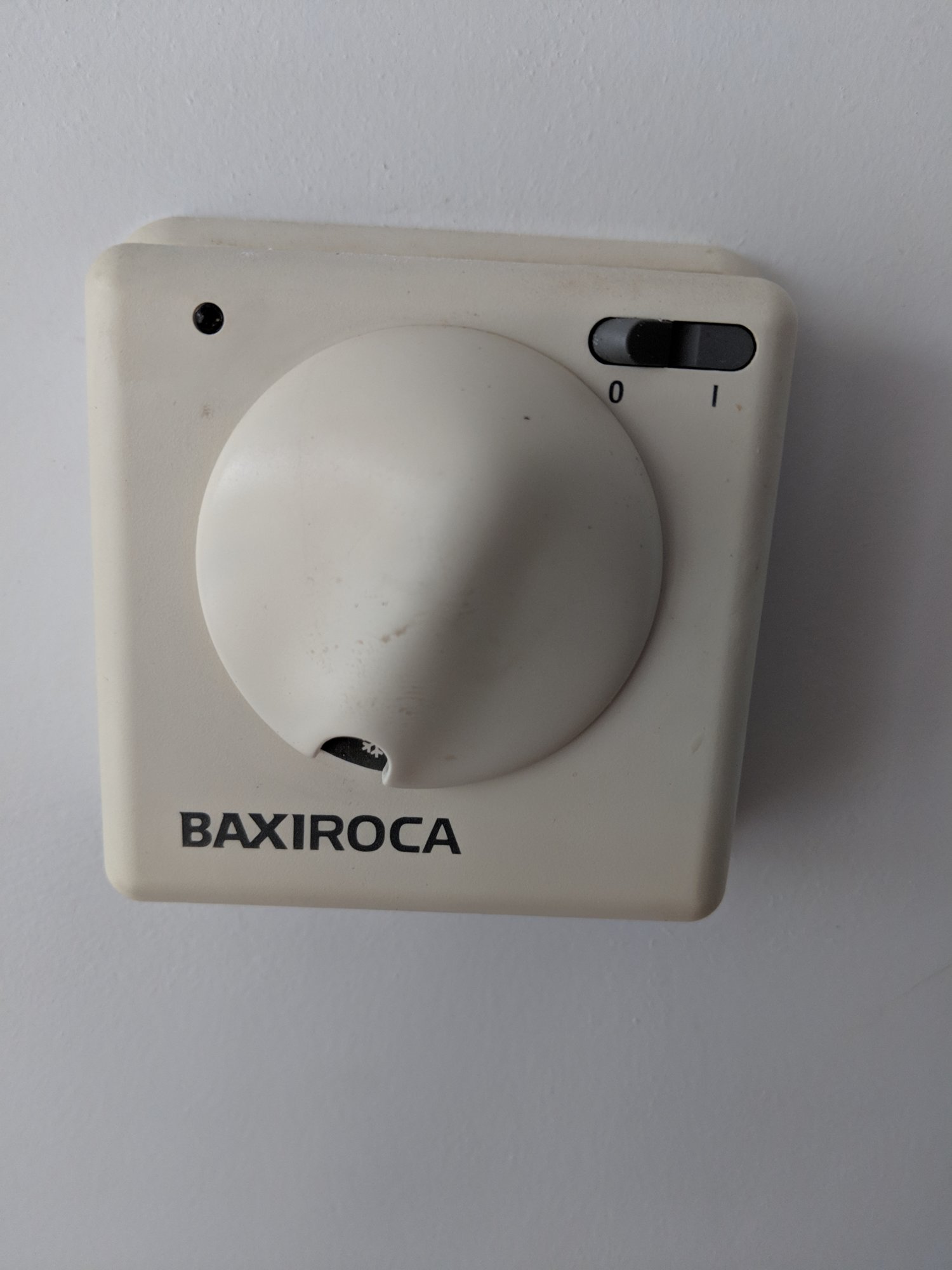

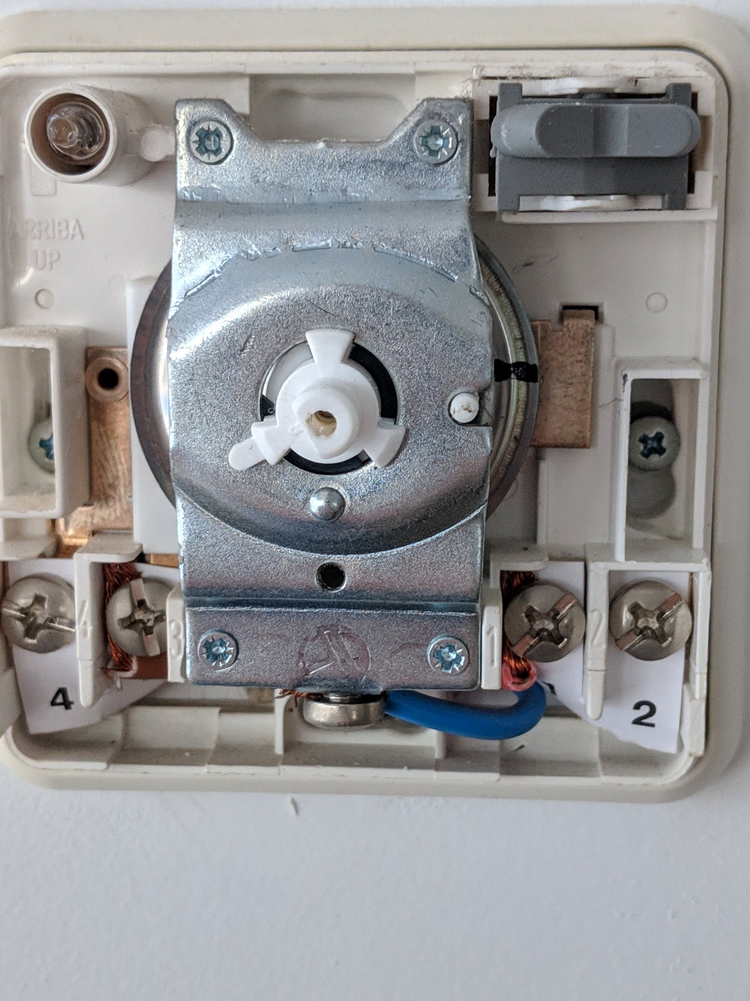

CH combi without programmer - need new stat
You won't get a simple on and off via the internet, the ones you get are programmable room stats. Well in saying that you could get a plug unit that that is just an on and off that's controlled via the internet to switch the boiler on and off but that would just be convoluted and a farf and could cause more problems.
Get someone in to install a web controlled programmer.
There are devices that allow ON OFF control via telephone call to a land line phone and when the devices answers the phone you key in a code to cntrol relays. No internet required
One such device is THIS self assembly kit.
Ready made devices that are approved for use on UK land lines are also available.
