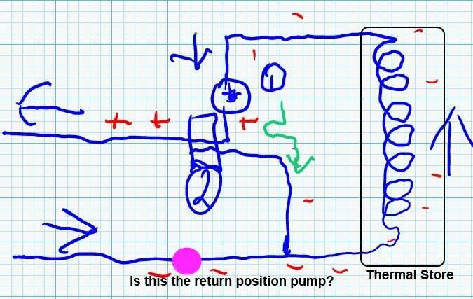

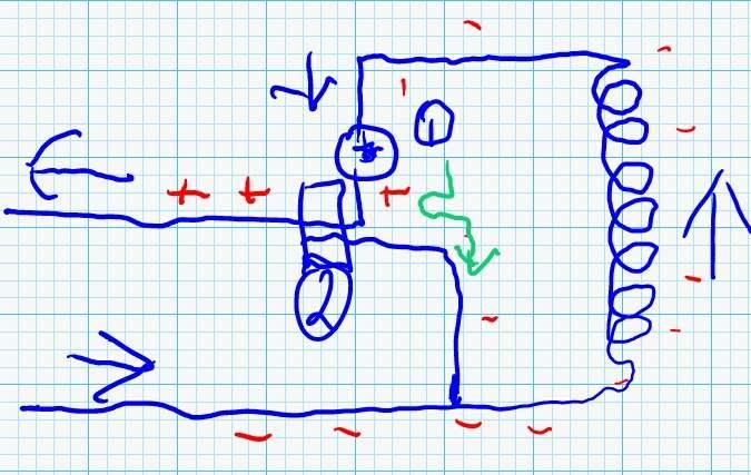

OK, no comments on the quality of the diagram :).
1 = the pump
2 = blend valve
pipes going off the the left = ch system.
the blue arrows are the intended flow.
This is how it has been plumbed. I don't know if blending valve are non-return. The coil is the coil in the thermal store.
My question: is this a valid configuration?
It seems to me that if the water is too hot, then the valve will open to cooler return water, but because of the pump being on the hot flow only, the water will actually want to flow the wrong way down the cold inlet side of the valve to return through the coil and back to the low pressure (inlet) side of the pump. (the green arrow).
There will be no pressure diff to push the cold inlet water into the system.
Can somone explain / verify ....
TIA - I have a few more thermal store / fire questions, but think I should ask them one at a time.
Is there a fault ie. does the system work?

It isn't the way I'd expect to see it done, assuming the 'spiral' is meant to be the thermal store.
The simple answer is to look at the valve to get the manufacturer's name and valve type and then look on the internet for the installation instructions.
One of the 3 ports will always be open and the pump is connected to that.
Thanks to both. In terms of "3 port", it is a blender, i.e. I think they are designed to limit the outbound water temp by feeding in cooler water (there is a similar think on the water for the hot water taps) i.e. blend not on/off.

The PDF doesn't seem to cover radiators and a thermal store. The only one that looks anything like it is fig 1 on Page 116, where the pump is inside the circuit.
The thermal store is a Gredhill Torrent MultiFuelStore SF.
I can't see with the pump before the hot feed, how any water can make it from the return side of the rads, through the blender as the pump is drawing the water through.
Any thoughts appreciated.
That looks more like a hot water secondary circulation loop with the pump fitted incorrectly.
Should be on the return loop with an nrv fitted upstream.
The VTA 313 is designed for potable water.
I understood all the words, but just not together :). Potable = drinking water, I read from the spec that it is used in basin set up and another model is used in heating circuits.
Will it be OK to use the same blender or should I get it replaced?
The return loop: so inside the loop - see purple bit.
So it is definately shouldn't go where it is?
And where on my beautiful schematic should the NRV go?[/quote]

Ah, sorry, I should have been clearer. I had diagnosed this down to it definitely being the CH circuit.
I can see my art work is confusing :), drawn on my Galaxy Note. In actual fact this coil occupies a much narrower height, above the solar and below the hot water in and around the same height as the gas boiler send / return.
My bottom pipe (left) is the return from the rads. The top left pipe is the rad send. (2) is the ESBE. OK, so looks like I should replace the valve. Now to the place the pump should be positioned (on my diagram).

Hi, so modified pic from Gledhill catalogue - all rights are theirs and apology for bad updates:
The purple box and the blue line are the bits I am talking about (i.e. the blender and its current position). The other line I have updated is that the stove cold (or return to the stove) is at the bottom I think.
I can certainly take pics if that would help. You want the pump / blender?
In my bad diagram you can see that the colder water returning from the rads enters at the bottom and exits higher up as you say (matt1e). The pump looks like normal heating circulating pump (red, 3 "speed" settings).
Thank you all for your patience with this. I'll get a pic of the pump. I am 100% sure this is the CH circuit. The sealed boiler has and an integral pump. The pump I ref has a feed from the thermostat and there are no pumps on the HW.
I'd remove that valve.
It's serving no purpose other than possibly diverting flow back to the store thus preserving the temperature to a degree.
The HW coil should be above that level and be unaffected ideally.
Those pretty diagrams are for illustrative purposes only. They show a three port valve on the flow from the boiler and the connections to the store coil. Again not needed.
