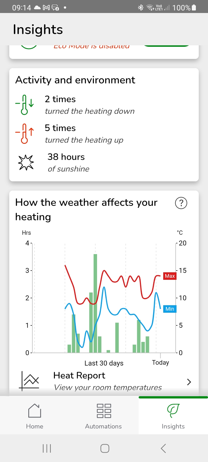

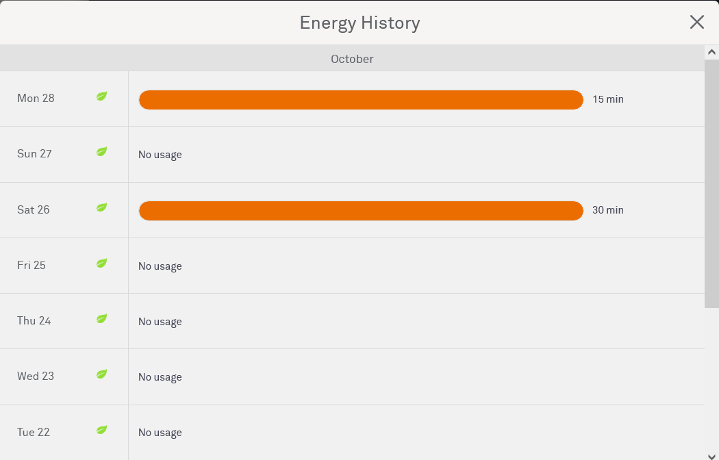

However both give info on how the heating is working, 1730193221274.png 1730193354199.jpeg neither are any good, as neither gives whole picture. I know the Nest Gen 3 can learn, not looked at wiser as yet, but I know with Nest all the bells and whistles had to be turned off, had heating fail because the EE mast was damaged in high winds, that is not what I want. It would fire up DHW to stop legionnaires, but the iboost+ was heating the DHW with solar.
Both Nest Gen 3 and Wiser will work with OpenTherm, but my boiler will not, and I don't think there is any way to get two OpenTherm thermostats to work together, only simple on/off type.
Anyway the two thermostats work OK for me, the Nest in hall is reasonable average of whole house, but hall is slow to cool, so Wiser ensures living room does not get cold, but can't using living room only as it has doors to outside and a open fire, and the Wiser does not do the DHW only the room temperature. So now I have best of both.
Had I wanted OpenTherm then it would have been very different.

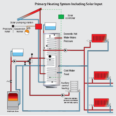

I am sure if I was designing the house, I could fit some thing like this Torrent pipe example.PNG and all would be fully integrated. However house already built, and hard to install new wiring or plumbing, so have to work with what I already have, wires from hall to utility room I assume was thermostat to programmer, the utility room to under house in the flat starts as red, yellow, blue, arrives as brown, black, grey, and some where clearly a hidden joint, and one core open circuit.
So 1) seems prudent to use extra low voltage, 2) need to control both central heating and domestic hot water with two wires. 3) also need to power it using same two wires, so question was, what will do that, and the answer was Nest Gen 3, however it was found in spite of what they said, it did not connect in a meaning full way with the energenie TRV heads, it did connect, but not in any helpful way.

I am sure if I was designing the house, I could fit some thing like this View attachment 360911 and all would be fully integrated. However house already built, and hard to install new wiring or plumbing, so have to work with what I already have, wires from hall to utility room I assume was thermostat to programmer, the utility room to under house in the flat starts as red, yellow, blue, arrives as brown, black, grey, and some where clearly a hidden joint, and one core open circuit.
