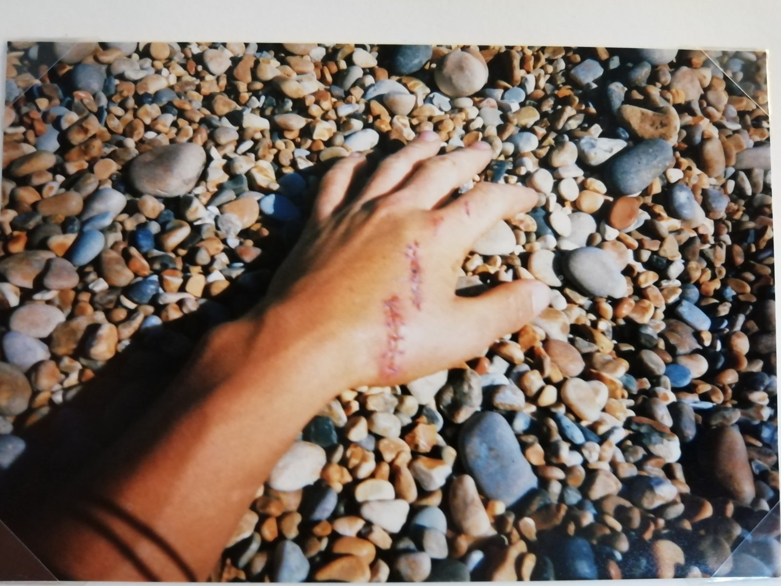

There’s me, and the tens of thousands of people that injure themselves with chainsaws.
The large majority of chainsaw injuries are to the left hand.
Is this not true?
Once you include me and the other tens of thousands in your answer to Q3, all that remains is to debate whether chainsaw gloves, by design, offer better protection than builders gloves.
When have you ever heard anyone say that chainsaw gloves are better than builders gloves?...
I have never heard that said. But I don't base my answer on the absence of a few opinions.
Chainsaw gloves are not pleasant to wear. For comfort I would agree with your advice on wearing builders gloves. But comfort takes second place to safety- hence 'safety first'.
But, after using a saw for about 4 years every day, I finally quit wearing gloves. I was good at using the saw, knew the pitfalls had some near misses and was surrounded by people that had, in their safety careers 'quit’ gloves sooner than I had. We all thought they were not ‘a thing’. And
then I cut myself. The people that worked with me, started to wear gloves, and as far as I am aware still do.
