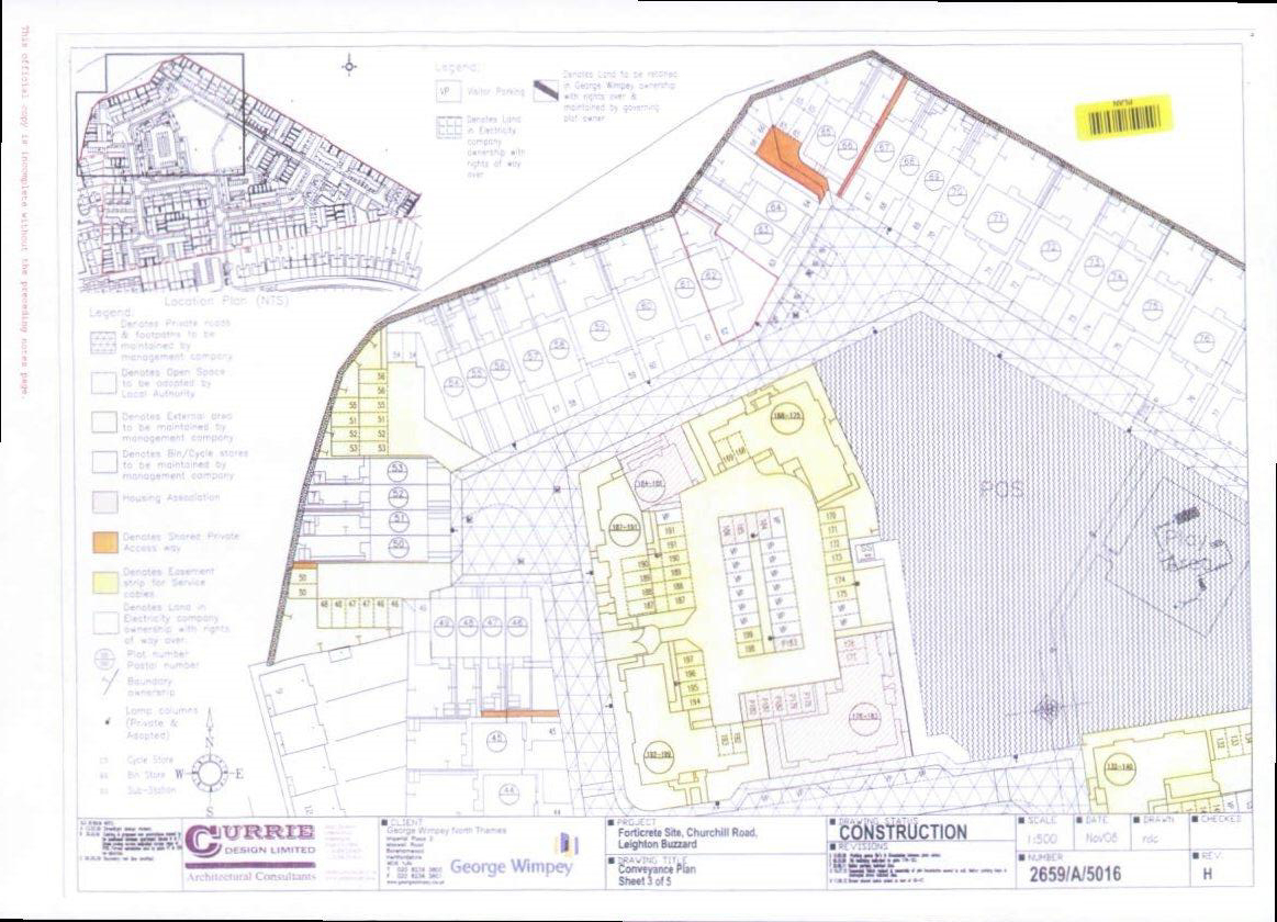

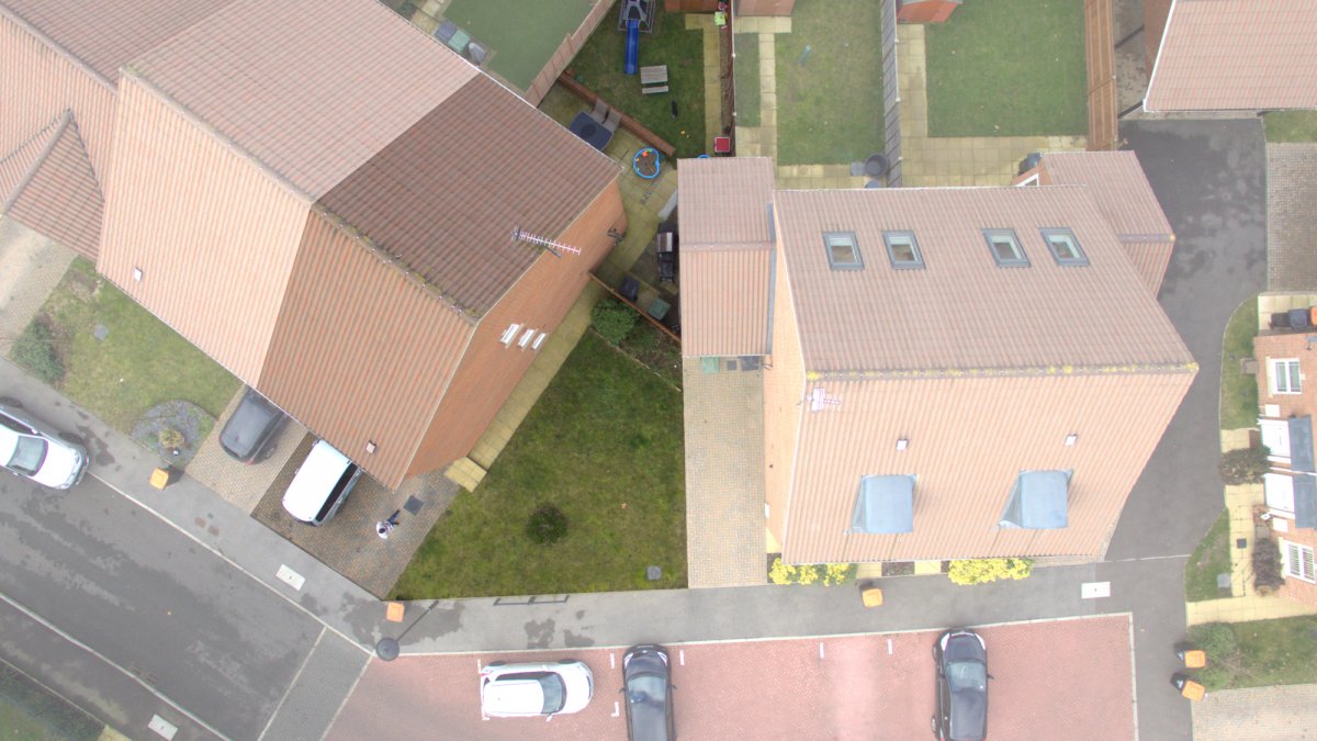

I have been in talks with Central Bedfordshire Council who believe that our land adjacent to our home is classed as amenity space. Our deeds and Land registry show it as our land, no mention of such amenity space.
I believed that it would be feasible to erect a new fence boundary to create a larger rear garden space, however, CBC are saying that we need to apply for a change of use planning application at the fee of £385!
Now, I don't mind paying the fee and completing necessary paperwork, but they are just stating that under planning laws this is the case - I for one cannot find any information regarding this and Taylor Wimpey are just pointing me towards CBC for further information.
Does anyone have any information regarding this specifically? We are only going to landscape the land to be used as a rear garden, not building on it.
Please see attached information which hopefully helps?!

It looks like straightforward domestic curtilage land. I can't see how it can be amenity land - what information does the council have to support this?
This is the issue, they aren't supporting it with anything other than stating it falls within planning laws and amenity space on newer developments. I am awaiting further information from the planning officer, I feel that I have a right to fence the area as pictured which leaves some amenity space - it's just such a shady piece of legislation which I know nothing about - perhaps they are merely trying to make a bit of money in the hopes I just go straight to planning rather than seeking further advice or information. The local councillor has advised that he doesn't know about amenity space and also cannot get involved until an application is refused and goes to appeal.

It will be on the original planning permission for the estate and/or plot. It may or may not be in the deeds
I have checked the original plans, there is nothing on there regarding land from the homes becoming amenity space, only the land in the middle (a green space with play area). I have seriously exhausted finding out any further information. I am awaiting an email from CBC today so I shall update you with their response.

This situation doesn't sound right to me. Amenity space is just a generic term for outside space associated with a property for the enjoyment of the occupants, a private garden is amenity space. From the aerial photo it just looks like a residential front garden so I cannot see where the change of use is coming from. Are they arguing that it is communal amenity space? but that just doesn't look right in this case. There would have to be documented proof somewhere that the front garden is classed as communal amenity space and as such is non-residential.

Anyhoo, it looks like your planners are classing your front garden as "open" amenity space. This seems rather harsh to me as it clearly looks like your front garden and not part of the public domain, but it needs someone with considerably more expertise than me to advise. For instance could they take enforcement action if you planted a small hedge rather than erected a fence?
