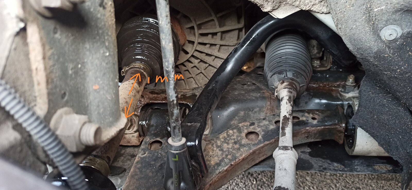

I took the problem side wheel off and lubed all the rubber joints with rubber friendly silicon spray, then I rubbed some rubber friendly silicon grease over each for good measure. Unfortunately my can ran out of gas so I've yet to do the other side. The creaking is harder to notice while driving now but still there, awaiting on an order for some more spray and red rubber grease (apparently better than silicone) for the other side and hopefully get a silent drive again. Is there anything that would need lubing on the rear wheels?
I've put my hand over all the joints and bars pulling with fair force and recorded all movement. First the NS and OS wheels while attached have no visible play, they are equal, so I don't know why these guys said they weren't, the tyre rubber compresses a bit but the rim doesn't move at all. If I pull to the left or right and quickly push hard to the other side I can feel a tiny clunk or shift, but it is far too small a movement to see and is equal to both wheels, I don't know if that is normal or indicative of anything.
With the wheel off, I genuinely can't feel any movement on the track rod, I can't see any of the symptoms to require changing it, aside from the wheel being knocked out of alignment (which can happen after any pothole impact). The only movement I found was on the Dive shaft. I was able to push and pull it ~1mm. It rotates smoothly and makes no noises while manually moving.

The driveshaft is supposed to move in and out a bit. It needs to do this because as the suspension moves up and down, it will have to be able to change length a little.
A lot of balljoints are spring-loaded, so unless you have the weight of the car resting on the wheels, you may not feel any play with just your hands. In addition, the car spends most of its time with the suspension around its mid-laden position, so that's where the wear will be worst. If you take the wheel off and let the suspension hang a full rebound you might not feel any play, because you've moved the worn surfaces out of contact with each other. Mottie has described how to check for ball joint and track rod end wear. Did you grab the inner tie-rod balljoint (through the rack gaiter) to feel for any play there?
Yes but I had the steering wheel turned while the car was in the air.
Unfortunately I don't have anyone to turn the wheel at the moment, with the car on the ground the tie rod end possibly has some play. It's not visible to the eye, but it feels like it rocks <0.1mm, though I'm really doubting whether I can feel anything at all. For the inner tie rod it's much the same pushing it forward and back via the end of the rack gaiter, I can't feel any movement grabbing the ball joint through the rack gaiter.
