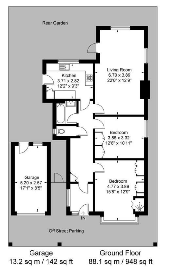

Currently the property has a small bathroom and I am trying to think of ways of improving the layout to increase the size of the bathroom and open up the living room and kitchen while still keeping the sizes of the 2 bedrooms. I am trying to avoid spending lots of money on a large extension and wondered what ideas others had - I appreciate that I will need an architect/structural engineer if I was looking to move forward.
Knock down the wall between the bathroom and the toilet.
Knock down the wall between the kitchen and the living room.
Lose the larder.
Block up old kitchen door.
Block up old bathroom door.
Must be the simplest and cheapest way.
Sorry I should have added the toilet and the bathroom would be too small even if the wall was removed. The dimensions aren't on the diagram but they are small.
Is the garage used?
Is there a passage between the garage and the toilet to the rear of the property?
Why would the bathroom and toilet knocked into one still be too small?
What do you intend doing in there?
It's very cramped at the moment, you can see in the diagram the door is hitting against the bath tub which is small as well.
Yes, but with that door blocked up, and you enter through the toilet door (which incidentally opens outwards to save space), it shouldn't matter.
