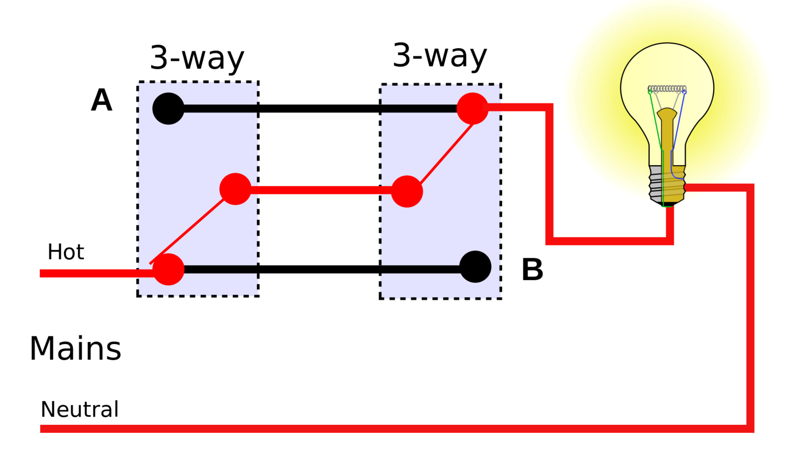

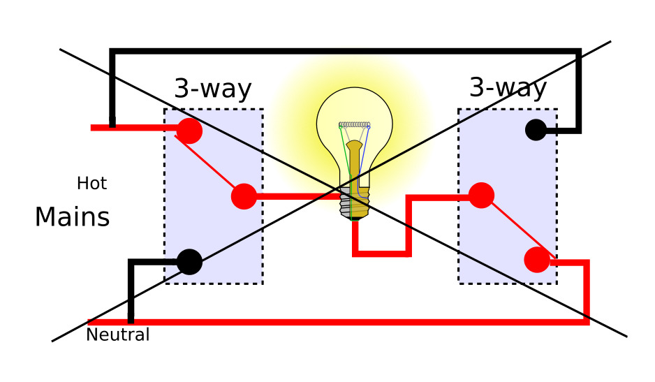

The "California" system is a highly dangerous contraption that only works with DC-rated switches, in Germany it's known as a Hamburg 2-way circuit. Connect line and neutral to L1 and L2 of both switches and one wire from each COM to the light. Depending on the position of the switches, the light gets either N+N (off), L+N (on) or L+L (off). That means both poles of the light socket(s) can be live even though the light is off, which is quite dangerous with Edison sockets. Apart from that, rocker switches don't have enough of a contact gap to safely break an arc before it turns into a full short in this setup, so they usually burn out fairly quickly if someone replaces the ancient rotary or toggle switches with new rockers.

You are thinking of the "Carter" system -where the Line AND Neutral can be "switched".
See https://en.wikipedia.org/wiki/Multiway_switching

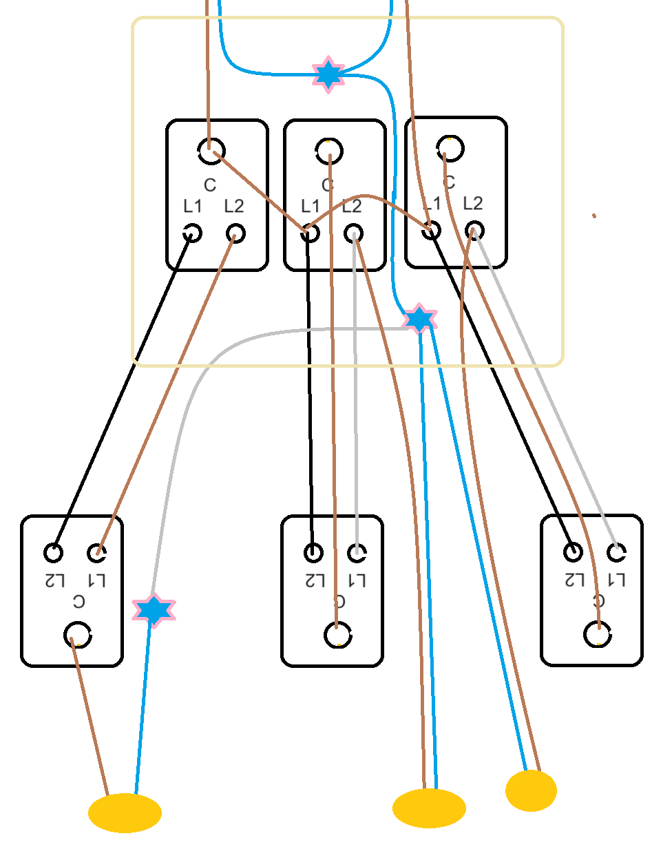

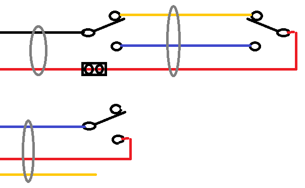

My assumption with T&E + 2*3C&E with a spare yellow core
I have called that school boy wiring, the connector block is not required if wired like this
and if the coms are correct, it does not matter about the other two wires which way around.
View attachment 336923and if the coms are correct, it does not matter about the other two wires which way around.
And three wire wiring is like wiring the enter, wait, busy lights outside an office, and I have seen flick switches with centre off, but not seen any with the three positions so work three way, always used rotator switches for over two way. I suppose this View attachment 336925 could be called a three way switch, but we would normally call it a 3 gang switch.
I think it's unfair to call it 'schoolboy wiring' when it used to be THE way of wiring 2 way switching and even today I still see recent work executed this way, just last week I replaced a (newbuild from last year) broken 3G switch containing 3x 2 way circuits and 4 wagos (2*N & 2*SL). The basic problem being there was not enough room for 4 wagos and the screws heavily tighted to make it flush and cracked the faceplace.
This made so much more space although it did add 4 wires into the switches

I learned the term "California three-way" for the illegal method years ago reading the ECN forums, a professional-only environment with some amazingly knowledgeable electricians from the US.
It seems like the name is used for both the legal and the illegal method of wiring a 2-way circuit, not surprising with a term that was never officially recognised.
